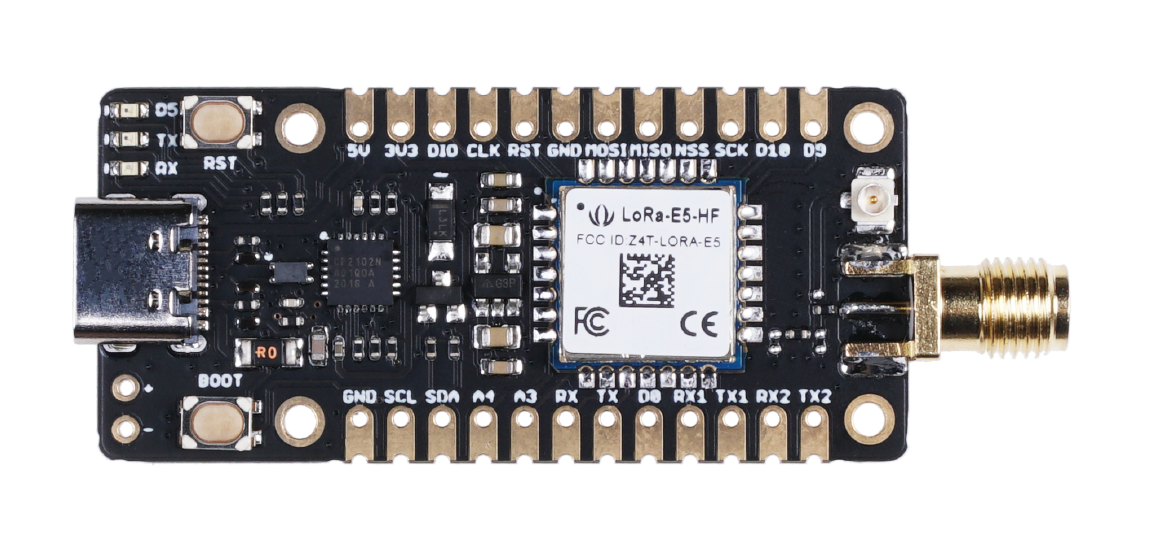

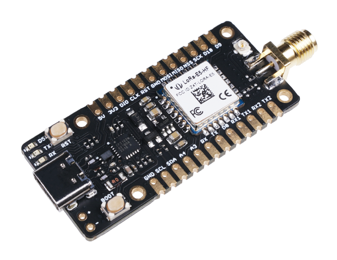

The compact-sized LoRa-E5 mini has the powerful SeedStudio’s LoRa-E5 STM32WLE5JC Module that has everything you can imagine. The module is packed with ARM Cortex-M4 core and Semtech SX126X LoRa chip to support the LoRaWAN protocol. This spectacular STM32WL module LoRa-E5 STM32WLE5JC module is an ultra low power, extremely compact-sized design offering the high performance of TXOP equal to 22dBm at 868/915MHz.
LoRa-E5 mini Dev Board Top View
It becomes very important to note here that when LoRa-E5 mini dev board is compared to the newly launched Potenta Vision Shield- LoRa, the former is equipped with ARM Cortex-M4 that achieves lower power consumption because of the smaller number of instructions to realize a certain operation with respect to the ARM Cortex-M0+ (in Arduino’s dev board).
With the existing support for the LoRaWAN protocol, the LoRa-E5 is capable of ultra-long-range transmission at low power consumption over a range of up to 10 km. The development board provides all the GPIOs that come with the LoRa-E5 STM32WLE5JC module that has UART, ADC, SPI, IIC, and many more. The manufacturer has designed it with a good set of interfaces required for the user. You can power the board with USB Type C or through the port of 3.7/5V on the hardware.

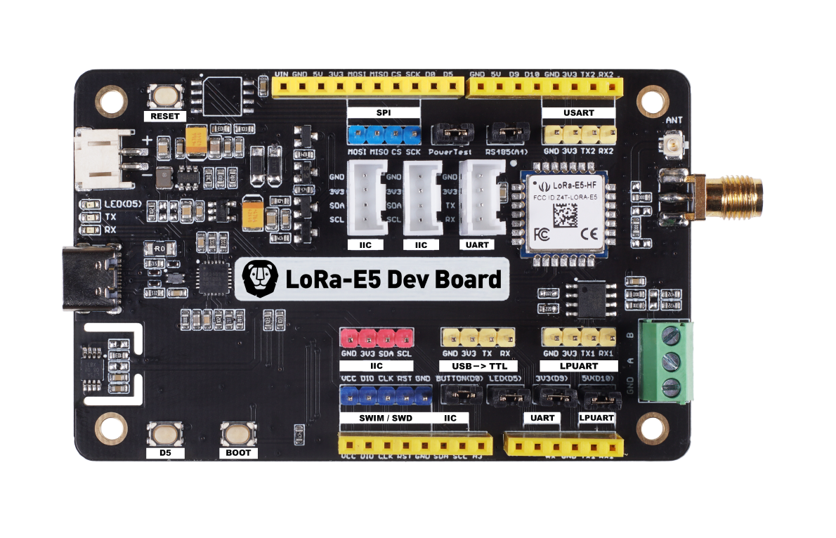

To add on more complex interfaces and explore the efficiency of the LoRa-E5 STM32WLE5JC module, the manufacturer has launched an upgraded version of LoRa-E5 to release the LoRa-E5 Development Kit. This includes more sets of GPIOs to add RS-485 and Grove interfaces allowing you to prototype at a faster rate.
LoRa-E5 mini Dev Kit
Either board has the same MCU that provides some basic features that are required to smoothen the user experience. With the availability of USB to UART function on the board, you can now connect the hardware to your PC with a USB type C cable. In addition to this usage of the UART function, you can interface the board to another mainboard via UART.
