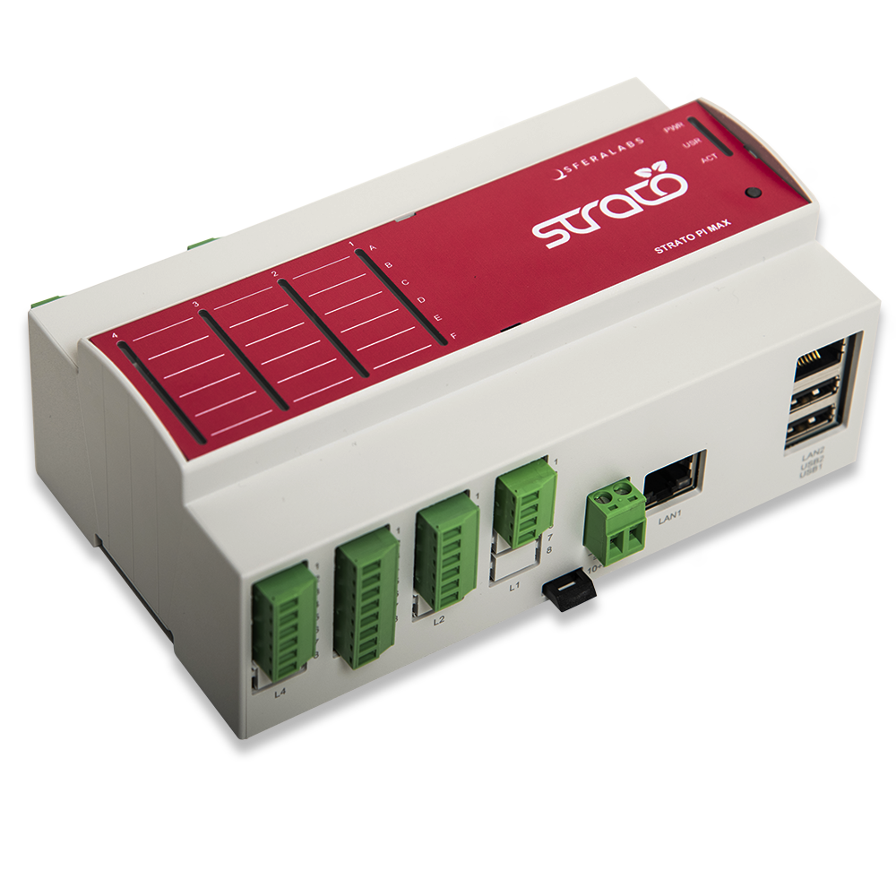

We have previously written about EDATEC ED-IPC3100, a Raspberry Pi CM5 industrial computer with a durable metallic case and DIN-rail support. Now, Sfera Labs just introduced the Strato Pi Max, which is also a DIN rail industrial controller built around the Raspberry Pi Compute Module 5 (CM5) with improved performance and scalability over previous CM4-based models.
Strato Pi Max Raspberry Pi CM5 industrial computer
Designed for industrial automation and IoT applications, it features dual Ethernet (Gigabit + 100M), dual USB 2.0 ports with power control, a Raspberry Pi RP2040 microcontroller for power management, and optional expansion modules. Expansion options include up to 16x RS-485/RS-422 ports, 4x CAN interfaces, multiple analog and digital I/O, and LTE connectivity.
The controllers come in two variants, the Strato Pi Max XS (1 expansion slot) and the Strato Pi Max XL (4 expansion slots with dual SD storage for redundancy). Security is enhanced with a Microchip ATECC608 crypto chip, and power management includes a hardware watchdog, 10-50V DC input with surge protection, and UPS options for reliable operation. Running on Raspberry Pi OS supports various industrial communication protocols and automation tasks, making it ideal for factory automation, building management systems, and industrial IoT deployments.

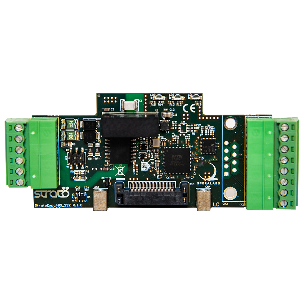

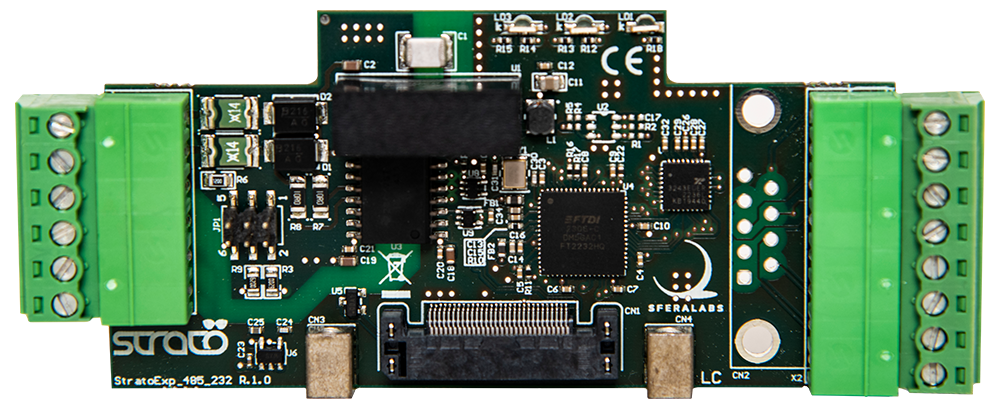

RS-232 and RS-485 X2-Series Expansion Board

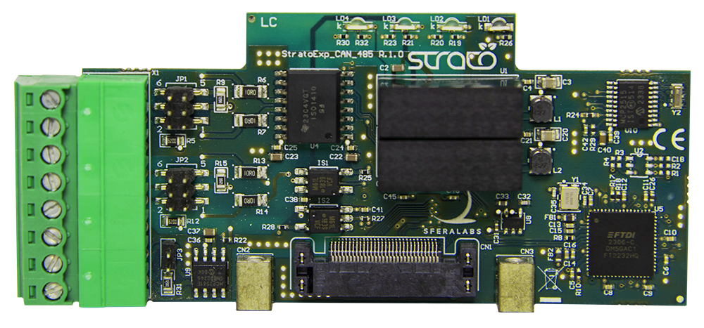

CAN and Dual RS-485 X2-Series Expansion Board
The device supports Raspberry Pi OS, Ubuntu, Debian, and other Linux distributions, with built-in drivers for RS-485, CAN, and GPIO. The RP2040 co-processor enables real-time control, while secure boot and optional TPM enhance security. It supports Python, C/C++, Modbus, and MQTT for industrial automation, with OTA updates for remote management. The company also provides API support and extensive documentation to ensure ease of development.
