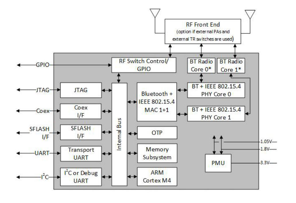

The Synaptics SYN20708 is a low-power IoT SoC designed for simultaneous handling Bluetooth 5.4 Classic/Low Energy, IEEE 802.15.4, along with Zigbee, Thread, and Matter protocols. Built using a 16-nm FinFET process, it features a 160 MHz Arm Cortex-M4 processor, 544 KB system RAM, 1664 KB code RAM, and integrated power amplifiers (PAs) and low-noise amplifiers (LNAs).
Additionally, it also includes features like high-accuracy distance measurement (HADM), angle-of-arrival (AoA), and angle-of-departure (AoD) to enable precise positioning. It also comes with coexistence interfaces like SECI and Bluetooth’s Adaptive Frequency Hopping (AFH) to ensure efficient multiprotocol operation in dense IoT environments. Operating within an industrial temperature range (-40°C to +85°C), the compact 5.5×5.5 mm SoC is ideal for industrial, consumer, and IoT applications requiring reliable wireless communication.

  • Connectivity:
    • Dual-radio Bluetooth 5.4
      • Bluetooth Classic and Bluetooth Low Energy (BLE)
      • Support for Bluetooth 6.0 features like High-Accuracy Distance Measurement (HADM)
      • Angle of Arrival (AoA) and Angle of Departure (AoD) support
      • Bluetooth Class 1 and Class 2 TX operation
      • BLE Long Range (BLE-LR) and ISO Channels (ISOC) hardware support
    • IEEE 802.15.4
      • Zigbee, Thread, and Matter protocols
  • RF Features:
    • Dual 2.4 GHz radios for concurrent operation
    • Integrated 2.4 GHz Power Amplifiers (PAs) and Low-Noise Amplifiers (LNAs)
    • Support for external PAs
    • Integrated Transmit/Receive (TR) switch with support for external switch
    • 4 GPIO and antenna-selection pins for AoA/AoD/HADM
  • Interfaces:
    • Synaptics-proprietary Serial Enhanced Coexistence Interface (SECI) for Wi-Fi/Bluetooth coexistence
    • 3-wire IEEE 802.15.2 coexistence interface
    • Optional SPI for local flash connection
    • I²C master for external sensor control
    • High-speed UART up to 12 Mbps
    • Peripheral/debug UART
  • Miscellaneous:
    • Electronic Shelf Label (ESL) support
  • Power:
    • 3.3V, 1.8V, and 1.05V external power supplies
    • Integrated Power Management Unit (PMU) and LDO regulators
  • Package:
    • 103-pin FCBGA package with 0.4 mm pitch
  • Dimensions:
    • 5.5 x 5.5 mm
  • Operating Temperature:
    • -40°C to +85°C (industrial range)
  • Process Technology:
    • 16 nm FinFET
