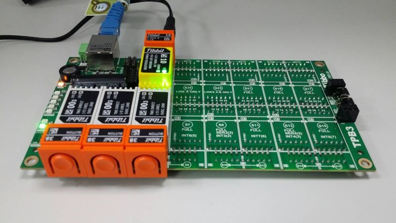

In our MQTT demo, the publisher device is monitoring three buttons (Tibbits #38). This is done through the keypad (kp.) object.
The three buttons on the publisher device correspond to the red, yellow, and green LEDs (Tibbits #39) on the subscriber device.
As buttons are pushed and released, the publisher device calls mqtt_publish() with topics “LED/Red”, “LED/Green”, and “LED/Red”. Each topic’s data is either 0 for “button released” or 1 for “button pressed”. The related code is in the on_kp() event handler.

  • On the publisher side:
    • TPP3 board in the TPB3 enclosure.
    • Your will need Tibbits #00-3 in sockets S1, S3, S5; and
    • Tibbits #38 in sockets S2, S4, S6;
    • You will also need some form of power, i.e. Tibbit #10 and #18, plus a suitable 12V power adaptor.

  • Open mqtt_publisher and mqtt_subscriber projects in two separate instances of TIDE, then correct the following in the projects’ global.tbh files:
    • OWN_IP – assign a suitable unoccupied IP to the publisher and to the subscriber (you know that they will use two different IPs, right?);
    • MQTT_SERVER_HOST – set this to the address of the PC on which your run HiveMQ.
  • Select your subscriber and publisher devices as debug targets, and run corresponding demo apps on them.
  • Press buttons on the publisher to see the LEDs light up on the subscriber.
