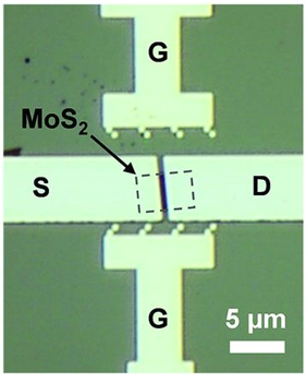

Optical image of a representative device shows the MoS2 flake, gate (G)
