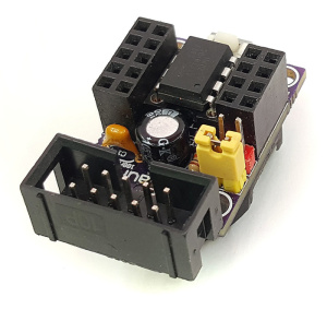

Tinusaur comes as an assembly kit, in parts, all in a small plastic bag, so you have to solder it yourself. In order to program this microcontroller board you will need a programmer like AVR ISP programmer, you can also use an Arduino to program the ATtiny microcontroller.
