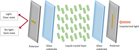

The system has an LCD-based light modulator that can be placed on a glass surface as well as an inner receiver.
“The modulator is an array of our proposed smart glass elements known as Dual-cell Liquid Crystal Shutters (DLSs),” says Osama Amin, one of the research team. “The liquid crystal shutter array, which would act like a filter to encode signals into the light as it passes, would require just 1 Watt of power to operate, which can be supplied using a small solar panel.”
The Dual-cell Liquid Crystal Shutter is also structured to use a light property called polarization in order to avoid uncomfortable flicker effects usually associated with existing optical wireless communication systems. “Change in light polarization is imperceptible to the eye, eliminating the flicker problem. The communication system works by changing the polarization of the incoming sunlight at the modulator side. The receiver can detect this change to decode the transmitted data,” one of the students in Shihada’s team, Sahar Ammar, explained.
