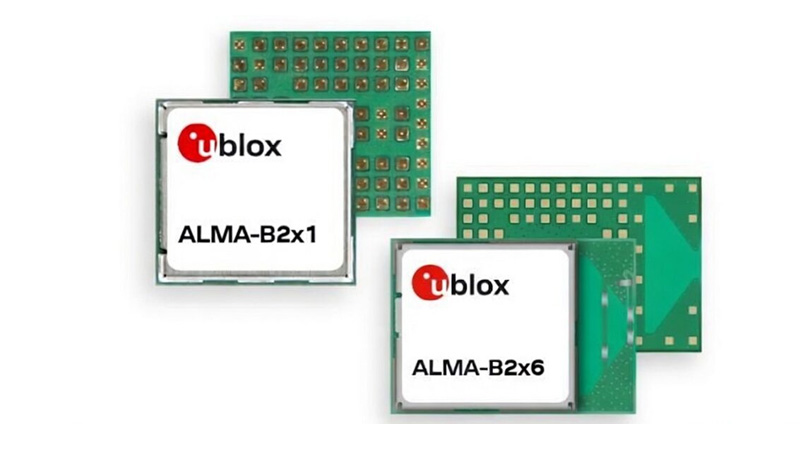

The ALMA-B2 family consists of four variants:
  • ALMA-B201: nRF54LM20A with external antenna
  • ALMA-B206: nRF54LM20A with integrated PCB antenna
  • ALMA-B211: nRF54LM20B with external antenna and integrated Axon NPU
  • ALMA-B216: nRF54LM20B with integrated PCB antenna and Axon NPU

u-blox ALMA-B2 Series Specifications:
  • Wireless SoC: Nordic Semiconductor nRF54LM20A (for ALMA-B201 and B206) or nRF54LM20B (for ALMA-B211 and B216)
  • CPU
    • Arm Cortex-M33 application processor clocked at up to 128 MHz
    • RISC-V coprocessor running at 128 MHz
  • Memory: 512 kB RAM
  • Storage: 2 MB of Non-Volatile Memory (NVM)
  • AI Accelerator: Built-in Axon NPU for hardware-based edge machine learning (only on nRF54LM20B variants: ALMA-B211 and ALMA-B216)
  • Wireless Connectivity:
    • Bluetooth LE 6.0 with PHY rates of 125 kbit/s, 500 kbit/s, 1 Mbit/s, and 2 Mbit/s
    • Bluetooth Channel Sounding (for highly accurate distance measurement)
    • Bluetooth LE long range (coded PHY), up to 1400m maximum range
    • IEEE 802.15.4 supporting Thread, Zigbee, and Matter
    • Nordic Proprietary 2.4 GHz protocol and NFC
    • +10 dBm maximum radiated output power (EIRP)
  • Antenna Options:
    • External antenna connector (via pin) – ALMA-B201 and ALMA-B211
    • Internal PCB antenna – ALMA-B206 and ALMA-B216
  • I/Os (via LGA pads):
    • Up to 66x GPIOs
    • 1x USB High Speed (HS-USB)
    • 1x HS-SPI + 6x SPI
    • 6x TWI/I2C
    • 1x HS-UART + 6x UART
    • 3x PWM
    • 14-bit SAADC
    • PDM, QDEC
    • 7x timers
  • Security: Arm TrustZone, secure boot, secure key management, secure FOTA, hardware crypto-accelerator, physical tamper detection, and debug access port protection
  • Power:
    • Supply voltage – 1.71V to 3.60V
    • Power consumption – 4.8 mA in Active TX (@ 0dBm), 4 µA in Standby, and 700 nA in Sleep mode
  • Dimensions:
    • 10.4 x 11.2 x 1.9 mm (Antenna pin variants)
    • 10.4 x 14-.3 x 1.9 mm (Internal PCB antenna variants)
  • Weight: < 1.0 gram
  • Operating Temperature: -40°C to +85°C

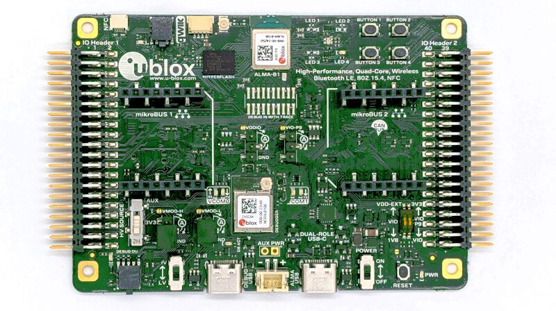

u-blox will also offer EVK-ALMA-B211 and EVK-ALMA-B216 evaluation kits for development. Early samples will be available in the coming weeks, with more information on the official product page and in the press release.
