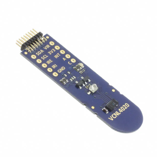

The VCNL4020C is a fully integrated biosensor and ambient light sensor. Fully integrated means that the infrared emitter is included in the package. It has 16 bit resolution. It includes a signal processing IC and features standard I2C communication interface. It features an interrupt function.
  • Package type: surface-mount
  • Package form: SMD
  • Dimensions (L x W x H in mm): 4.90 x 2.40 x 0.83
  • Integrated modules: infrared emitter (IRED), ambient light sensor (ALS), photo diode (PD), and signal conditioning IC
  • Interrupt function
  • Supply voltage range VDD: 2.5 V to 3.6 V
  • Supply voltage range IR anode: 2.5 V to 5 V
  • Communication via I2C interface
  • I2C bus H-level range: 1.7 V to 5 V
  • Floor life: 72 h, MSL 4, according to J-STD-020
  • Low stand by current consumption: 1.5 μA
