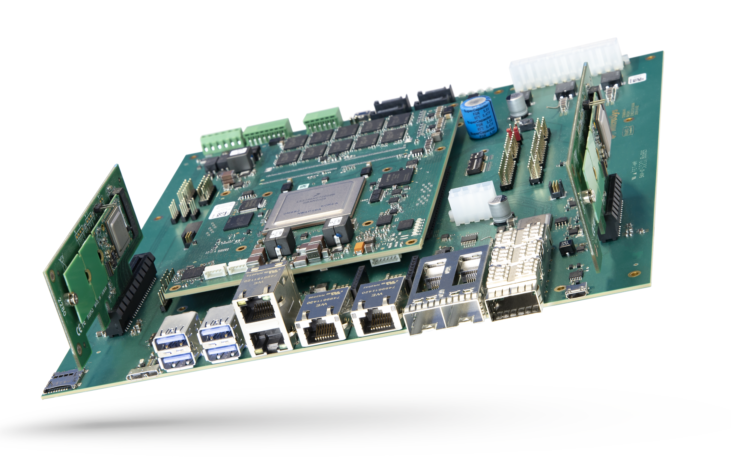

The company released a miriac® AIP-LX2160A dev kit with up to 5x integrated Hailo-8™ AI accelerator modules for processing performance up to 130 TOPS. They also released a miriac® MPX-LX2160A module which is used as a foundation for the kit.
The AIP-LX2160A kit is equipped with 2x 25GbE, 2x 10GbE, 2x 1GbE ports as well as 16x PCIe lanes (PCIe x8, PCIe x4, and PCIe x4, each with 2.5, 5 or 8Gbps support). The dev kit also has 4x SATA III, 1x microSD, 4x USB 3.0 host, a micro-USB 3.0 OTG port, 3x serial ports (UART/USB console, TTL, and RS485) JTAG, FlexSPI, 2x I2C, 6x-in/6x-out SPS, 4x LEDs, temperature sensors, fan controller, boot select, an RTC, a 12V input and ATX power supply with a 200W minimum, and 0 ~ 80°C operating range.
The MPX-LX2160A module, on the other hand, runs Linux on NXP’s 16-core, Cortex-A72 Layerscape LX2160A, which we have seen on high-end networking boards. The module also offers 2 Gbits Octal SPI flash, 8GB to 256GB eMMC, and up to 128GB of DDR4.
Hailo’s Hailo-8 M.2 AI acceleration module for AI applications offers industry-leading AI performance for edge devices. The combination of the Hailo-8™ AI acceleration module and the Arm® Cortex® NXP® Layerscape® platforms offers the benefit of integrating highly efficient AI in connected edge appliances. According to MicroSys, the embedded platform is the first ever to deploy up to 5x Hailo-8 cards on a single device and the aim is to help users get the most out of AI and neural networks.
