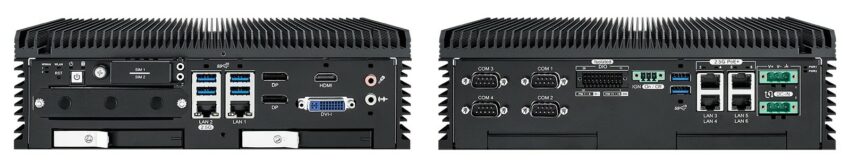

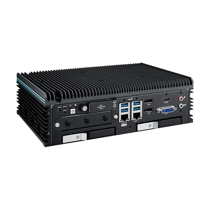

Vecow ECX-4000: Fanless embedded AI Edge System with Intel Core Ultra 200S, W880 PCH, and Intel X710 10GbE
Vecow's ECX-4000 series is a fanless embedded AI computing system powered by the Intel Core Ultra 200S Series (Arrow Lake) processor and Intel W880 PCH. It supports up to 96GB of dual DDR5 memory and features Intel’s hybrid architecture with up to 24 cores, an integrated NPU for AI acceleration, and Intel Xᵉ LPG Graphics.
Vecow’s ECX-4000 series is a fanless embedded AI computing system powered by the Intel Core Ultra 200S Series (Arrow Lake) processor and Intel W880 PCH. It supports up to 96GB of dual DDR5 memory and features Intel’s hybrid architecture with up to 24 cores, an integrated NPU for AI acceleration, and Intel Xᵉ LPG Graphics. Designed for edge AI applications, it is suitable for in-vehicle computing, intelligent logistics, smart city infrastructure, and public security.
The system offers extensive connectivity with up to nine Ethernet ports, including two 10G SFP+ cages, five 2.5GbE ports (four with PoE+), and a 1GbE port. It supports SUMIT expansion and features a 9V to 50V DC redundant power input for reliable operation in industrial environments. Additional I/O interfaces include four COM ports, six USB 3.2 Gen2 ports, and two external SIM card slots, making it adaptable for various AI-driven industrial applications.
