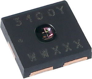

The Optoelectronics group of Vishay Intertechnology, Inc. today introduced a new AEC-Q100 qualified ambient light sensor for automotive and consumer applications where very high sensitivity is needed for sensing light through dark cover materials. The Vishay Semiconductors VEML6031X00 features a highly sensitive photodiode, low noise amplifier, 16-bit ADC, and infrared (IR) channel in a miniature, opaque 2.67 mm by 2.45 mm surface-mount package with a low 0.6 mm profile.
The Automotive Grade device released today enables ambient light spectral sensitivity close to that of the human eye. The sensor offers detection with highly linear behavior from 0 lx to 228 klux — eliminating the need for a correction formula — while its resolution down to 0.0034 lx/ct allows for operation in applications with low transmittance (dark) lens designs. The VEML6031X00’s IR channel enables light source detection and sensitivity adjustments to compensate for lux errors.
