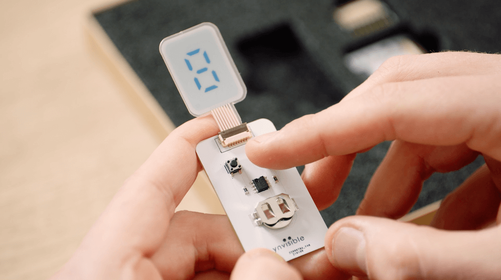

Vancouver-based display manufacturer has announced a new low-power printed e-paper display that consumes 50% less energy per switch than its predecessor and can last 10 times longer when switched on and off. The low-energy consumption display features an improved performance of faster processing speeds at especially low temperatures and provides a high-quality print display.
Ynvisible e-paper display
The company claims it to be one of the thinnest displays on the market that can even be stored inside a cardholder. Due to its highly customizable features, the e-paper print display has positioned itself well in the printed display space. The e-paper display kit contains various display designs, a manual display driver, and an I2C interface.

Specifications of Ynvisible e-paper display
  • Product type: Segment e-paper print display
  • Contrast ratio: 1:3
  • Angle dependency: No, Lambertian
  • Thickness: 300 μm
  • Dimensions: 1mm to 100mm
  • Response time: 100 to 1000ms
  • White reflectance: 40%
  • Supply voltage: 1.5V
  • Energy consumption: 1mJ/cm2
  • Operating temperatures: -20°C to +60°C
  • Pulse energy: 0.25mJ/cm2
Ynvisible e-paper print display
Ynvisible e-paper print display uses electrochemical reflective technology with very low angle dependency. The low-power display features semi-bistability, which means that the display consumes power during display switches but requires a short refresh pulse approximately every two minutes.
“This latest upgrade will significantly benefit specific industries such as digital signage, smart monitoring labels, authenticity & security and retail.”
The hardware requires very few additional components to add the Ynvisible e-paper display to a circuit. There are four circuit suggestions– voltage regulator circuit, DAC output on common electrode, a 2-level variable counter electrode, and digital outputs. For more information on the Ynvisible e-paper display, head to the product page, where the datasheet provides enough information on the hardware specifications.
