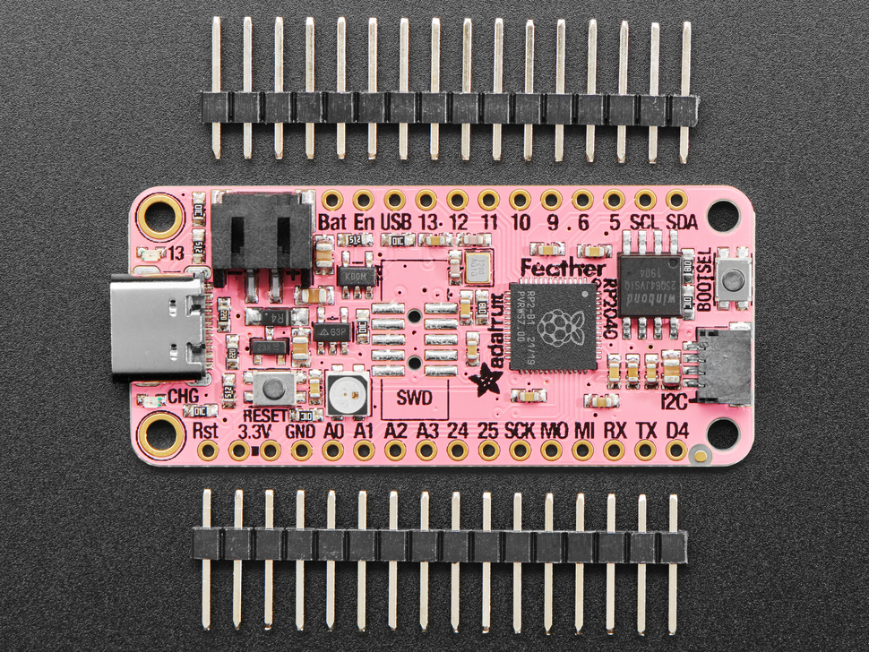

Highlight features and specifications of the Pink Feather RP2040 include:
  • MCU: RP2040 32-bit Cortex M0+ dual-core running @ 125 MHz @ 3.3V logic/power, 264 KB RAM
  • Storage: 8 MB SPI FLASH chip (for storing files and CircuitPython/MicroPython code storage), No EEPROM
  • Power: 3.3V Power/enable pin, 3.3V regulator with 500mA peak current output
  • Serials: USB -C connector (for accessing built-in ROM USB bootloader and serial port debugging)
  • Connectors/Interfaces:
  • 21 x GPIO pins including;
    • 4x 12-bit ADCs (+1 more than Pico), 2x I2C, 2x SPI, 2x UART peripherals (one is labeled the ‘main’ interface in standard Feather locations), 16 x PWM outputs, 8 digital non-ADC/non-peripheral GPIO
  • Misc: Built-in 200mA+ Lipoly charger with charging status indicator LED, Pin #13 red LED for general purpose blinking, RGB NeoPixel for full-color indication, Onboard STEMMA QT connector, Both Reset button and Bootloader select button for quick restarts (no unplugging-replugging to relaunch code), Optional SWD debug port
  • Dimension: 50.8mm x 22.8mm x 7mm
