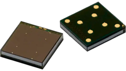

Differential current sensor – ACS724/725 SOIC8 sensor, galvanically isolated with common-mode field rejection. [via] The ACE-Q100 qualified differential Current Sensor ACS724 (5V)/ACS725 (3.3V) is a Current Sensor IC in SOIC8-package (automotive qualified) which is designed for application where small footprint, high sensing accuracy and independence of magnetic field noise is required.
Automotive by mixos
The ACE-Q100 qualified differential Current Sensor ACS724 (5V)/ACS725 (3.3V) is a Current Sensor IC in SOIC8-package (automotive qualified) which is designed for application where small footprint, high sensing accuracy and independence of magnetic field noise is required. With its industry leading noise performance, a bandwidth of 120kHz and a primary conductor resistance of 1.2 mOhm it suits perfectly into Automotive applications due to its accurate sensing output and low power consumption.
The sensor is certified from -40 to 150°C operating temperature and can measure a current up to +/- 50 Amps. The differential sensed current provides common-mode field rejection. That improves accuracy in magnetically noisy environments significantly.
Isolation voltage of 2400VRMS allows conducting of up to 420Vpk or DC on primary side. ACS724/25 in different packages are in development and are available shortly. These different packages allow isolation voltages up to 4800V.
