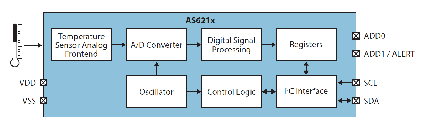

The AS621x is the second generation of the digital temperature sensor family, designed for high accuracy applications with ultra-low power consumption. The new digital sensor design offers eight I²C addresses and a supply voltage from 1.71 V to 3.6 V. The AS621x family is a fully calibrated and linearized sensor system that is easy to integrate into any digital system. It provides a 16-bit resolution over the full temperature range from -40 °C to +125 °C. For power-sensitive applications, the device can enter a low-power wait mode with 0.1 μA current consumption.

  • Ultra-low Power Consumption: 6 μA @ 4 samples/sec (Typ.)
  • Small WLCSP Package (1.5 x 1.0 mm)
  • High Temperature Accuracy of ±0.2 °C (-10 °C to 65 °C)
  • Full-digital System with up to Eight I2C Addresses
Additional features:
  • Supply voltage: 1.71 V to 3.6 V
  • Operating temperature: -40 °C to 125 °C
  • Programmable alert output pin
  • Factory calibrated
