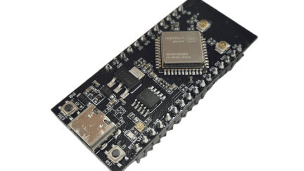

Apple has recently released a beta version of Embedded Swift programming language that is said to work with ESP32-C6, Pi RP2040, STM32F7, and nRF52840 microcontrollers. Additionally, the company has also developed example codes for matter protocol based on ESP-IDF and ESP-Matter SDKs that help to accelerate development and foster innovation in the smart home and IoT space.
Apple is expanding Swift’s reach beyond mobile apps into the realm of microcontrollers. Previously, it was used on Mad Machine’s SwiftIO boards. Now, Apple has created “Embedded Swift,” a streamlined version of Swift tailored for microcontrollers. This new subset is currently compatible with STMicro STM32F746, Raspberry Pi Pico, nRF52840, and ESP32-C6.
