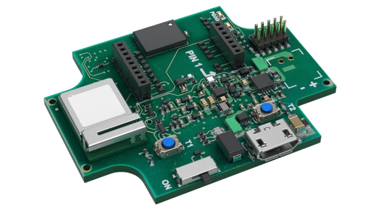

Bosch Application Board 3.0 is a versatile and sensor-independent development platform for evaluating various sensors. The Application Board 3.0 shuttle board socket allows a wide range of Bosch Sensortec’s sensors to be plugged in.
Bosch Application Board 3.0 is a versatile and sensor-independent development platform for evaluating various sensors. The Application Board 3.0 shuttle board socket allows a wide range of Bosch Sensortec’s sensors to be plugged in. The application board 3.0 and shuttle board 3.0 evaluate sensors and builds prototypes to test use cases.

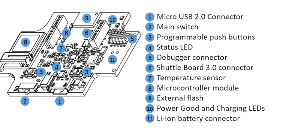

The Bosch Sensortec Application Board 3.0 is a closed system used to configure sensor parameters and plot and log the resulting sensor readings through PC-based software (Desktop Development) and COINES.
The Application Board 3.0 uses the uBIox NINA-B302 Bluetooth Low Energy module based on the nRF52840 chipset from Nordic Semiconductor. The nRF52840, among other features, supports USB 2.0 and Bluetooth Low Energy 5.0. It is based on an Arm® Cortex®-M4F CPU and flash program memory.
