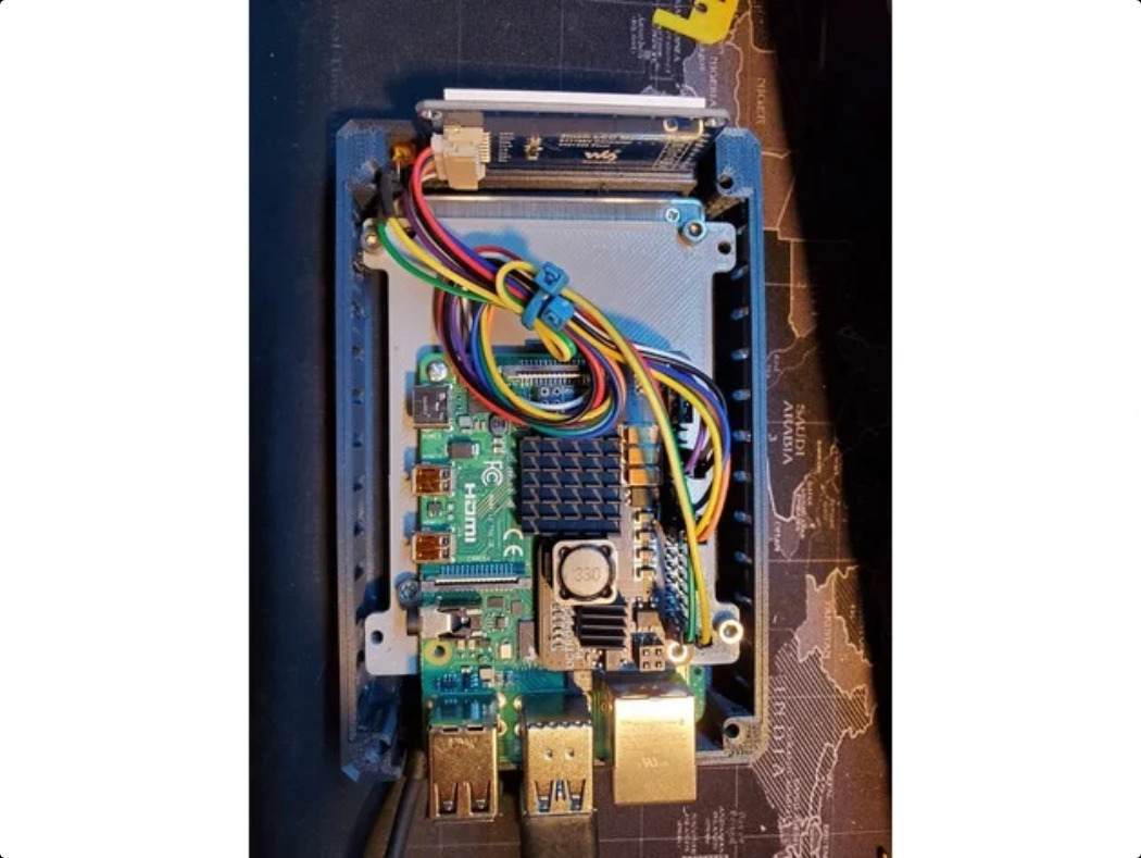

NAS units are generally available. However, NAS can get quite expensive, so one solution is the DIY solution, which is cost effective compared to a readily available solution. Recently, a Redditor named CodemanHB posted his project, which demonstrates his personal small-scale solution utilizing a Raspberry Pi and a custom 3D-printed case. His NAS unit comprises of a Raspberry Pi 4 4GB version, an Uctronics PoE HAT, a 240×320 pixel 2″ IPS LCD display module, a 500GB SK Hynix SATA III SSD, and a USB to SATA adapter cable. He also designed the SSD to serve as the main storage device, and also store the OS for running the NAS.
The enclosure He used for the NAS is a 3D-printed case, which was designed in Fusion 360 and made with a Creality3D CR-10 3D printer. He also used a carbon fiber filament which gave the NAS a beautiful finish on the printed parts. You can find more pictures and information on CodemanHB’s Thingiverse page, and on his Reddit post.
