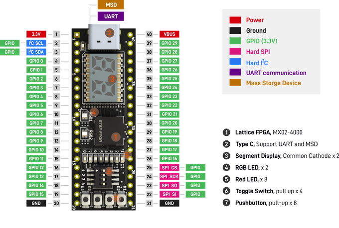

The miniature FPGA development board, the STEPFPGA MXO2Core is based on the Lattice MXO2-4000 FPGA chip. This chip is multi-purposeful and multi-functional as it incorporates features of both FPGAs and CPLDs (complex programmable logic devices). The chip’s built-in flash memory enables quick hardware configuration, which takes less than 10ms, while still incorporating 4000+ LUTs for moderate to commercial digital system design.
The board has 36 GPIO pins and by employing an internal phase-locked loop (PLL), the STEPFPGA MXO2Core’s clock frequency can be boosted from 12MHz to 400MHz. The MXO2Core board does not require the installation of any driver and takes only a few seconds to flash the chip. Additionally, the board also features a UART TX and RX module which aid in debugging with a serial COM port on your computer. The board also offers a block of RAM of 92 Kbit and a user flash of 64 Kbit.
STEPFPGA MXO2Core Specs
The components of this delicate board are lead-free, and Kickstarter mentions that some of the “0201 footprints parts are just a bit thicker than your hair”. Made up of a four-layer PCB with immersion gold technology, the board features interactive components like LEDs, segment displays, switches, and push buttons allowing people to interact and examine outcomes in a tangible way. Furthermore, the DIP40 footprint offers you the option of expanding your projects on a breadboard or embedding the board in your projects.
The STEPFPGA MXO2Core board supports development on its Web-based IDE and Diamond IDE platforms. The user-friendly MXO2Core board facilitates the development of FPGA projects using the cloud-based IDE, Verilog which provides abundant pre-built examples and a simple interface. It is also compatible with the MacBook, Windows, and Linux operating systems.
