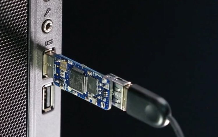

a new project is published on electro-labs.com, check it out: Another DIY project designed with FabStream’s SoloPCB tool is ready to be shared with Electro-Labs community. This is an USB stick which measures the supply voltage of the USB port and current drawn by the device connected to the port over the stick.
DIY-USB-Line-Power-Meter-Stick-Connected-to-Laptop-620x503
Another DIY project designed with FabStream’s SoloPCB tool is ready to be shared with Electro-Labs community. This is an USB stick which measures the supply voltage of the USB port and current drawn by the device connected to the port over the stick. Then it calculates the power consumption of the device and displays the whole information with the help of the small OLED display on the board. The stick itself is also powered from the USB port.
The board is built around an Atmel ATMEGA328 microcontroller. To make the circuit as small as possible, the MCU is used in minimal configuration. Internal 8MHz oscillator is used. The voltage and the current are measured by the internal 10 bit ADC. To make the measurements more accurate, an external 2.5V voltage reference IC, Microchip MCP1525 is included. The current is converted to voltage on a 0.01R sense resistor and precisely amplified by LT6106 before read. The stick can measure up to 2.5A. Since the OLED display requires 3.3V supply voltage, L78L33ACUTR linear voltage regulator is used.
