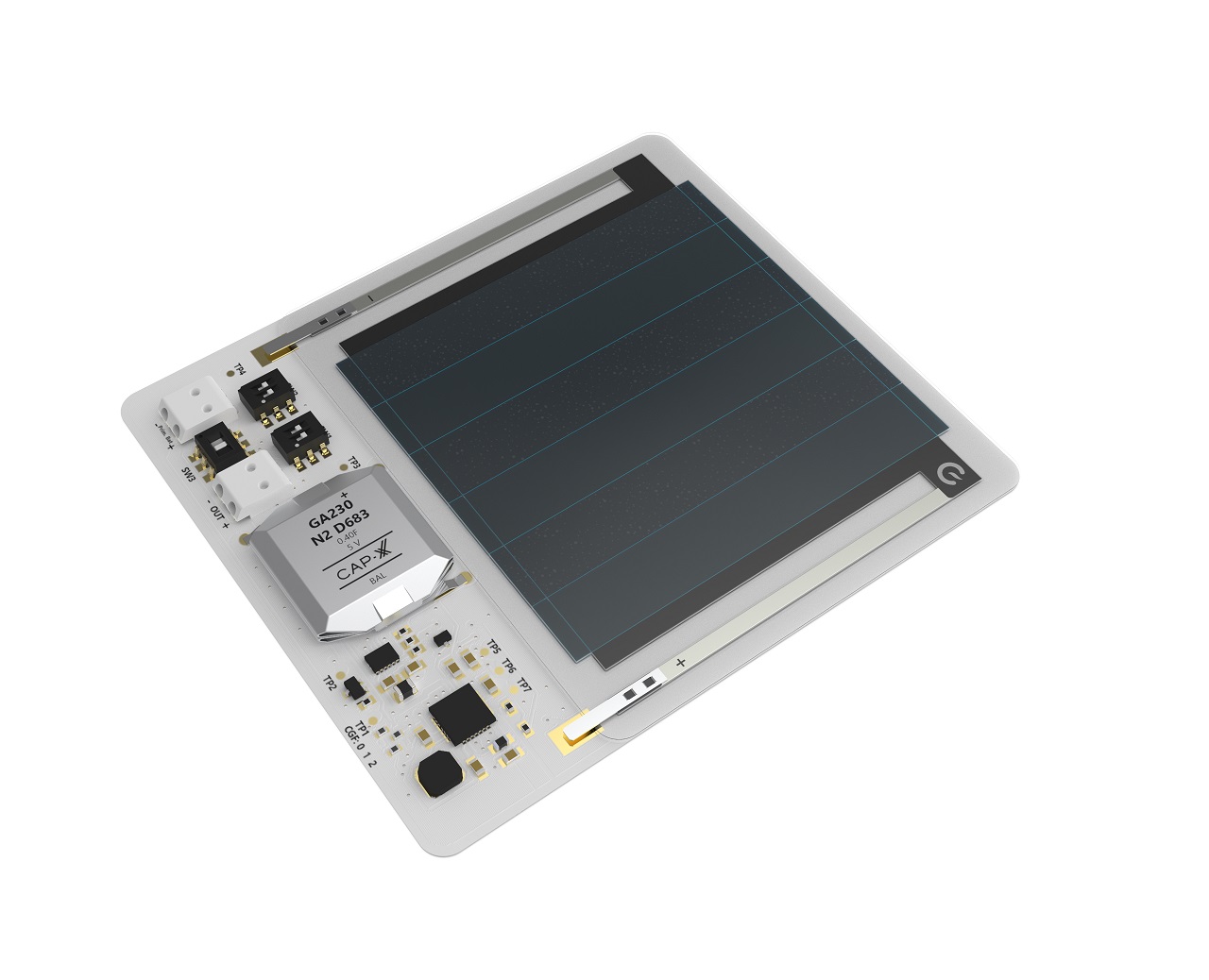

The Light Energy Harvesting Evaluation Kit (EK01LEH3_6) demonstrates how Epishine’s Light Energy Harvesting (LEH) modules can power indoor wireless low-power devices that are usually powered by batteries. It combines a 6-cell 50x50mm LEH module with a supercapacitor which acts as an energy buffer and intelligent charging management system to support various output voltages and energy storage solutions. It can even use an external primary battery as a backup. The evaluation kit can deliver sufficient output current to power most low-power wireless devices such as BLE, Zigbee, and LoRa. The ability to program the evaluation kit provides added flexibility and showcases the unique product integration and design possibilities of Epishine’s LEH modules.
Key features include:
  • Selectable output voltage ranging from 1.8V to 3.3V in 0.1V steps
  • Up to 300mA output current
  • Optimized for indoor use (-20°C to 40°C / 0-85%RH) with illumination intensities of 20 to 1000 lux
  • A supercapacitor for energy storage which can be reconfigured to charge rechargeable battery
