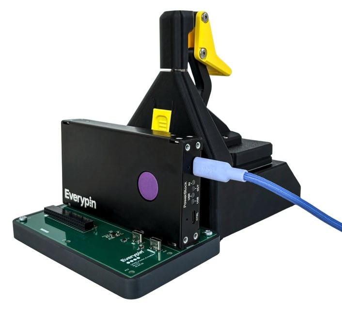

Everypin PwrBlock 323 in a test jig

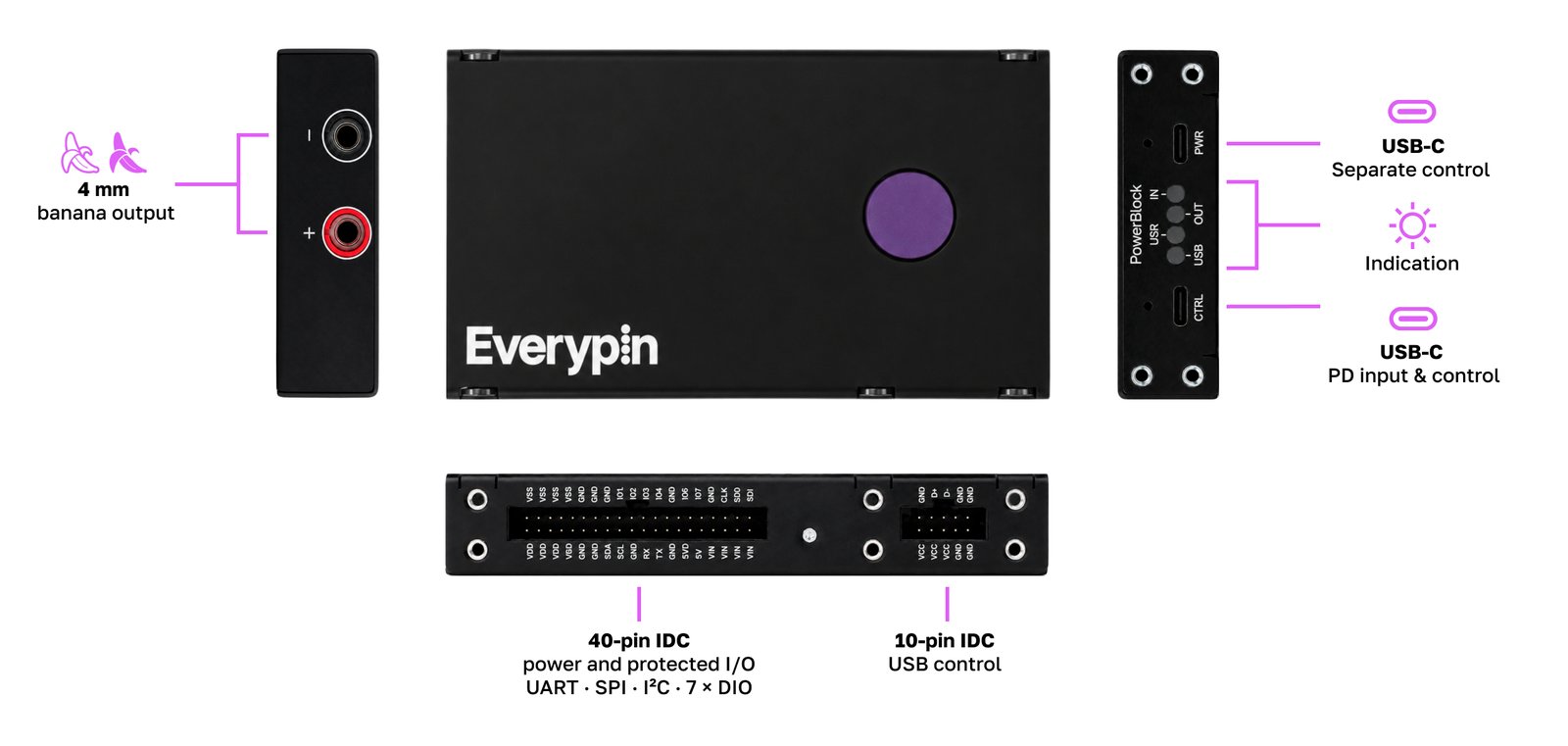

PwrBlock 323 Specifications:
  • Microcontroller:
    • STMicroelectronics STM32G0C1CEU
    • Arm Cortex-M0+ MCU
  • USB Connectivity:
    • 2× USB Type-C ports for power delivery and device control
    • 10-pin IDC USB control connector for connection to a host PC or automated test controller
  • Expansion and I/O:
    • 40-pin, 2.54 mm power I/O connector supporting VIN, VDD, and VSS
    • Protected I/O interface with:
      • UART
      • SPI
      • I²C
      • 7× digital I/O
  • Status Indicators: 4× LED indicators for USB, USR, OUT, and IN status
  • Power Input:
    • USB-C Power Delivery, nominally 20 V / 5 A
    • Alternative power input through the VIN pins on the 40-pin connector
  • Programmable Power Output:
    • Output voltage: 1–32 V
    • Output current: Up to 3 A
    • Maximum output power: Approximately 92 W
    • Output configuration: Single-channel, non-isolated
    • Output interfaces: 4 mm banana jack and 40-pin connector
    • Requires a 100 W USB-C PD power source to reach maximum output power
  • Voltage and Current Resolution:
    • Voltage resolution: 10 mV from 1–24 V
    • Voltage resolution: 20 mV above 24 V
    • Current resolution: 1 mA
  • Electrical Performance:
    • Voltage-setting accuracy: ±0.1% + 30 mV
    • Measurement accuracy: ±0.1% + 30 mV
    • Ripple: Up to 65 mVpp, based on prototype v0.1
    • Load regulation: ≤0.1% at tested output voltages
    • Peak efficiency: Up to 92% at 32 V / 3 A
  • Power Management ICs:
    • LM51772 buck-boost controller
    • INA229 precision voltage and current monitor
    • TPS259830 input protection IC
  • Protection Features:
    • Over-current protection
    • Over-voltage protection
    • Over-power protection
    • Over-temperature protection
  • Dimensions: 130 × 70 × 20 mm

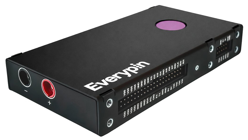

Everypin PwrBlock 323 Interfaces

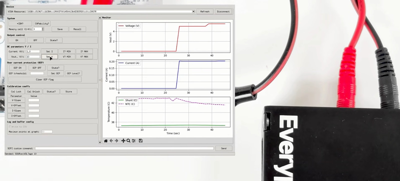

The organisation says the PwrBlock 323 can be assembled inside a test jig or stand using its mounting points and pin headers, with the DUT controlled and powered directly as part of the standardized automatic test sequence. It is an alternative to USB-C programmable lab power supplies such as Ampisu, PocketPD, and BenchVolt PD. The module can be operated via USB by SCPI commands and can be managed using Python, VISA compatible tools or custom test scripts. This enables test scripts to set standard current and voltage limits, switch on/off, and automatically read measurements in an automated test setup. The hardware design files, STM32 firmware, Python software, documentation, and GUI for the PwrBlock 323 will be posted to Everypin’s GitHub account soon. Hardware and mechanical files will eventually be made available under CERN-OHL-W-2.0 license, firmware and host software under Apache 2.0 license and documentation under CC BY 4.0.
Set voltage and current control limit from GUI
