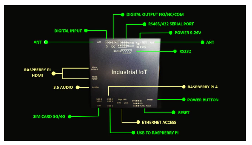

So, what is there about this shield developed by Akari? Firstly, it is an expansion board compatible with multiple SBC’s, more specifically: Raspberry Pi (models Zero, 3 and 4), Rock Pi and Jetson Nano. You can choose from three different options: Mini PCI Express, where you can connect a 4G module (because 5G coverage is still very lagging behind in many regions of the globe) or Wi-Fi 6, LoRa, USB, to use an Intel Compute Stick or M.2, allowing you to connect a 5G module. Besides that, the shield includes a wide voltage range (9 to 24 V), helping the integration with industrial applications, provides an RTC (Real Time Clock) module for time-keeping, a staggering 15 kV of ESD protection, along with a built-in relay, digital inputs / outputs, RS232 / RS485 and RS422.
Looking into the features present in this industrial shield:
  • Compatibile with Raspberry Pi Zero, 3 Model B and 4 Model B, Rock Pi and Jetson Nano (other boards may work, those are the ones listed on Kickstarter)
  • 3 possible connector options: M.2 (5G), Mini PCIe (4G, LoRa, Wi-Fi 6) and USB (Intel Neural Compute Stick)
  • Built-in relay module and digital input (with reserve dry and wet contacts)
  • Digital input and output and internal headers
  • Interfaces: RS485 / RS422 and RS232 serial ports
  • RTC module available even when power is out
  • Reset + power buttons and buzzer
  • 15 kV ESD protection (with pending CE / FCC certification)
  • Power: 9 to 24 V input and 5 A of maximum output current
