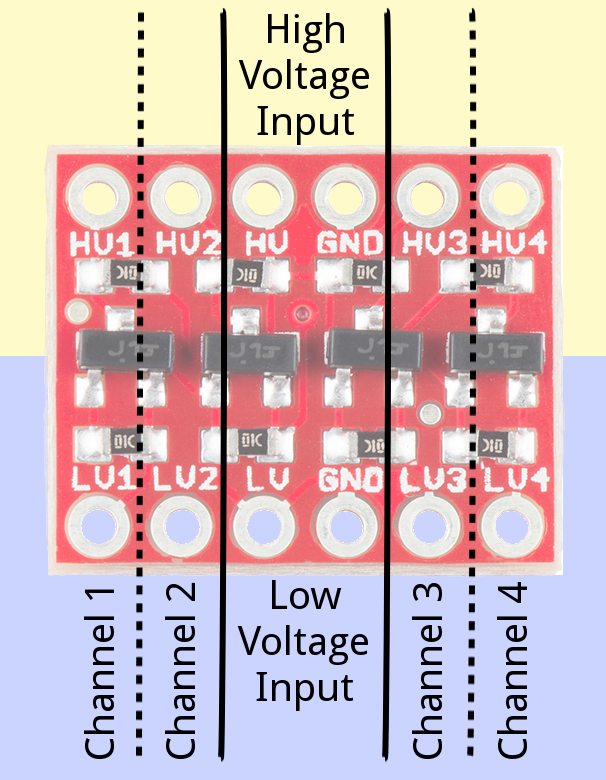

The Pinout:
The LC-04 logic level converter has two types of pins:
  1. Voltage input pins :
    • 2 pins (GND and LV) on Low Voltage  side
    • 2 pins (GND and HV) on High Voltage  side
  2. Data channels :
    • 4 pins (LV1, LV2, LV3, and LV4) on Low Voltage  side
    • 4 pins (HV1, HV2, HV3, and HV4) on High Voltage  side
Pin HV and LV set HIGH (logic 1) logic level on High voltage side and Low voltage side respectively, with respect to the GND.
Data channel pins shift logic levels from one voltage reference to another. A low voltage signal sent into LV1, for example, will be shifted up to the higher voltage and sent out through HV1. Similarly, a high voltage signal sent into HV1 will be shifted down to the lower voltage and sent out through LV1.
LC-04 Bi-directional logic level converter pinout

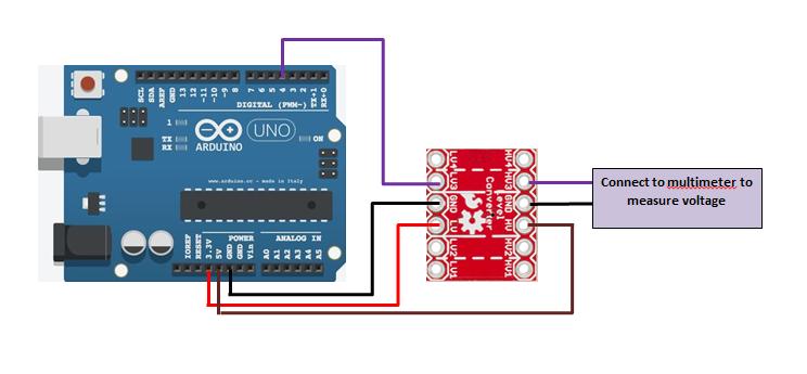

The Wiring:
The wiring is pretty simple. You may even omit the breadboard by making end-to-end connections. Two types of connections are required:
  1. Pin connection to shift down (5V to 3.3V)
  2. Pin connection to shift up (3.3V to 5V)
Pin Connection to Shift Down:
  1. LV to 3.3V
  2. LV’s GND to multimeter’s black probe
  3. LV3 to multimeter’s red probe
  4. HV to 5V
  5. GND to UNO’s GND
  6. HV3 to Digital Pin 4
Logic level shift down using LC-04 logic level converter
Logic level shifting down using LC-04 logic level converter
