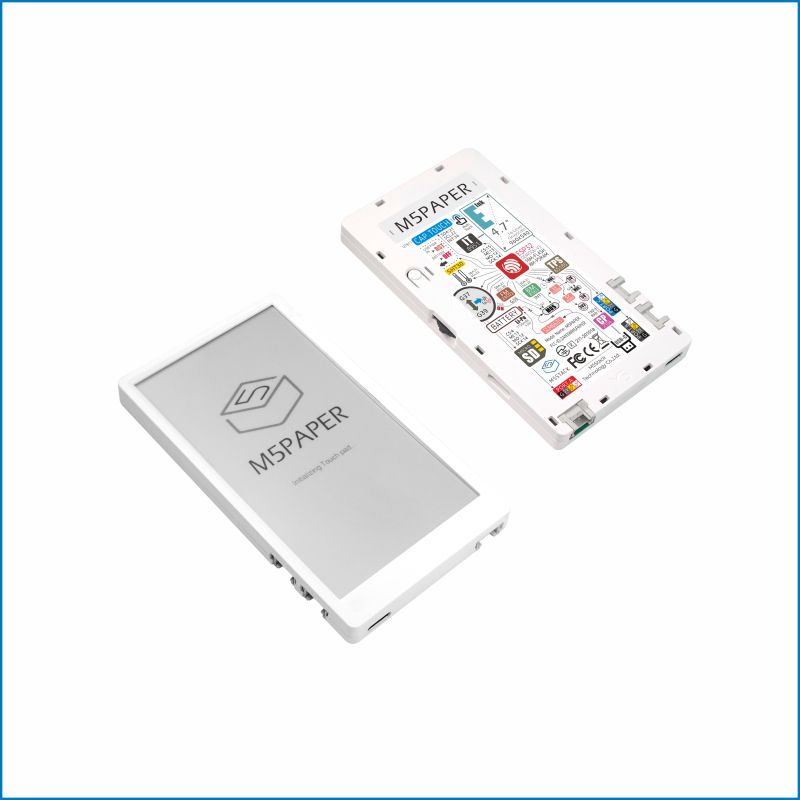

The M5Paper, from M5Stack sort of gives you a mobile phone vibe, with its 4.7” display and its tiny, component packed package. It is astonishing to look at it, and developing on it must be extra motivating.  But can this device be more than just the looks? It certainly can! Regarding its internals, you have more than just an e-ink display at your fingertips (even though it supports 16-level grayscale with 180º viewing angles, providing a stunning visual experience, and is a GT911 touch screen, with multi-touch support and many gesture controls). At its core, you have a 240 MHz, dual-core ESP32-D0WDQ6-V3, with 520 kB of SRAM, Wi-Fi, and dual-mode Bluetooth. You also get 16 MB of Flash and 8 MB of PSRAM memories and a MicroSD card slot, which may come in handy for the display. Regarding other peripherals, you have at your disposal a BM8563 RTC, an SHT30 humidity sensor, and a built-in magnet. When it comes to power, there are two options: its internal 1150 mAh battery or USB (5 V @ 500 mA), but the battery should not leave you hanging, considering the low power nature of the e-ink display and the ESP32 core. Lastly, you also have some room for upgrades, where the 3 HY2.0-4P external expansion ports will come in handy to accommodate existing sensors of the M5Stack ecosystem.
A rather deceiving look for such a feature-packed device, the M5Paper
