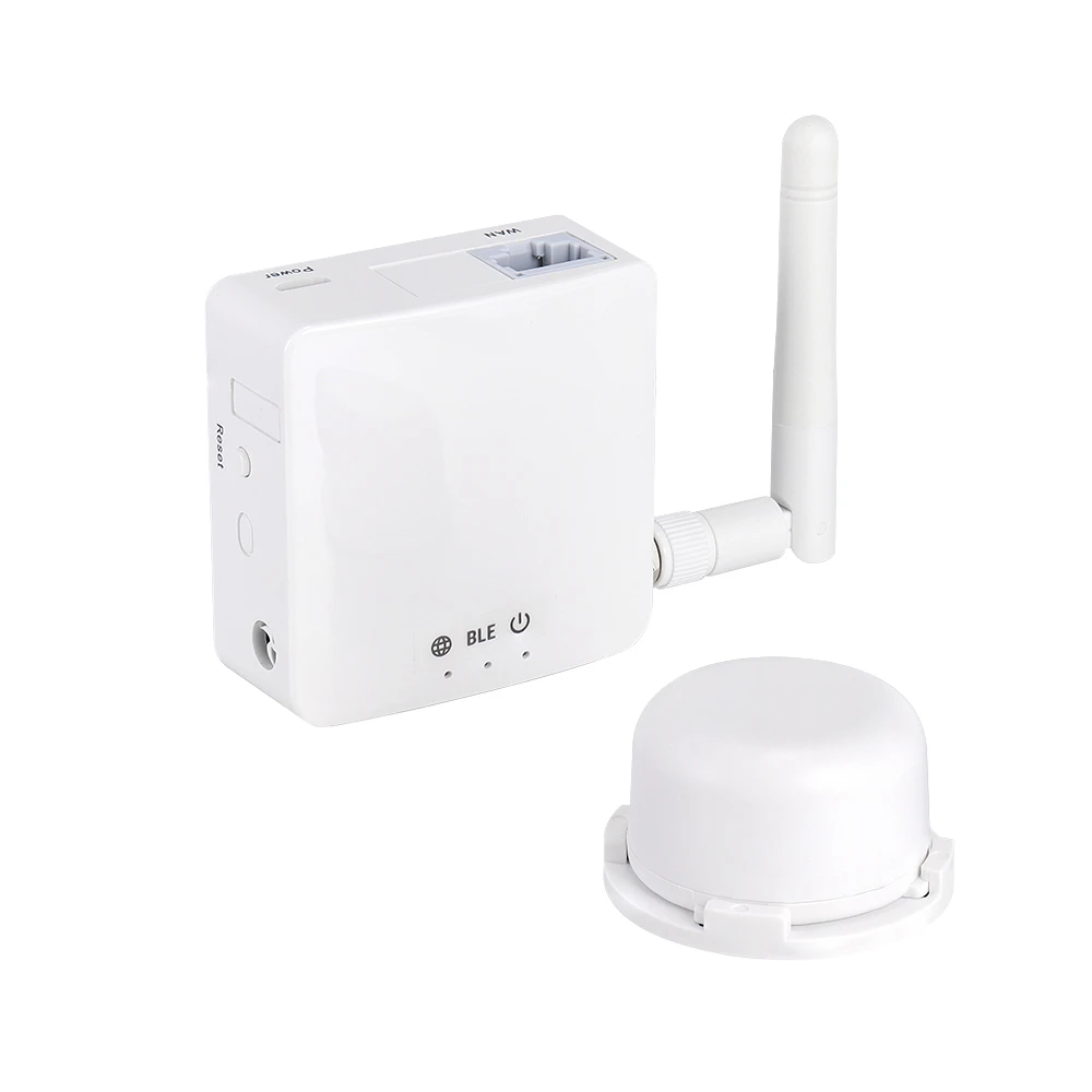

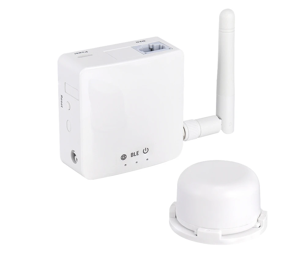

The GL-S10 is an IoT gateway with BLE and WiFi supports protocols for transmitting BLE messages to the cloud without the need for a web admin panel. Its BLE is built around GAP and GATT standards and certification, capable of functioning as either a Master or Slave server to talk with other available BLE devices within the coverage area. The GL-S10 can also communicate via WiFi as a station for parent access or the Internet via its Ethernet (WAN) port and this makes it a cost-effective solution. You should see it as your favorite for IoT communications.
The GL-S10 also has an onboard MQTT client to access any available standard MQTT server to transmit BLE broadcast data to the cloud destination. Apart from its support for an onboard Bluetooth module with a BLE communication distance of up to 80 meters, the device is said to support 802.3at/af standard PoE input supply.
