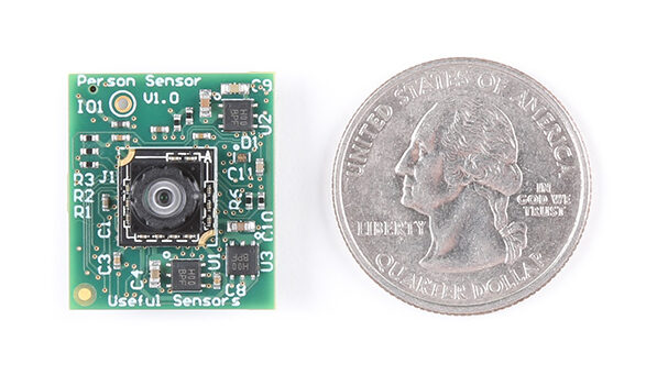

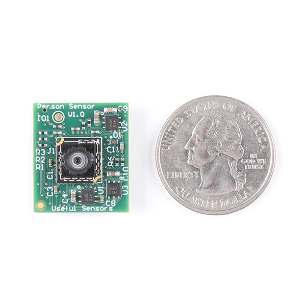

Useful Sensors has designed a small low-cost hardware module capable of detecting nearby faces and returning information about who they are, how many they are, and where they are with respect to the device. This Person sensor makes use of a camera and a small microcontroller, with pre-programmed machine learning algorithms that can recognize people right out of the box so there is no need to build or train any model yourself.
This Person sensor makes use of a camera and a small microcontroller, with pre-programmed machine learning algorithms that can recognize people right out of the box so there is no need to build or train any model yourself. The information gathered is sent back over a simple Qwiic I2C interface.
The Person Sensor is quite easy to use so you do not need any special technical expertise for it, even as a new user. Just power it up and face the camera in the direction you are interested in. There’s a dedicated pin that is used to indicate if any person has been detected. Also, ensure the lens is placed the right way since the sensor uses a camera sensor internally. Describing how it should be, SparkFun says:
“you should be able to see the side of the board that has the sensor by spotting the small lens in the center. You will know you have it the right way up when the silkscreen writing “Useful Sensors Person Sensor V1.0” is at the correct orientation.”
The sensor module is also designed with privacy built-in, allowing only metadata derived from each available frame and not raw image data.

  • 1x Pre-programmed microcontroller
  • 1x Qwiic Connector for the I2C interface
  • 110 degree Field of View for the Image sensor
  • Image scan rate (active with facial recognition): 5Hz
  • Image scan rate (without facial recognition): 7Hz
  • Low power consumption (150 milliwatts)
  • 3.3V operating voltage
  • 5 milliwatts LED power consumption
  • Up to 400k baud speed for I2C
  • Built-in privacy – module allows just metadata derived from each frame and not raw image data
