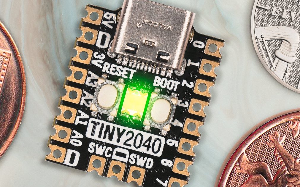

While most of these boards bring the powers of the RP2040 MCU to the user, they also come in a form factor that may not be ideal for projects that are pressed for space. This is why the Tiny2040, was designed, to give tiny projects a chance to experience the awesomeness of the RP2040 without custom-made boards.
Packed into a 22.9 x 18.2 x 6mm postage-stamp-sized form factor, the tiny2040 unlike most other boards exposes all the 4 available ADCs on the RP2040. It also comes with a debug port, an RGB LED, and the boot button doubling as a button that can be used for user input, and a USB-C interface so you don’t have to get an additional USB cable.

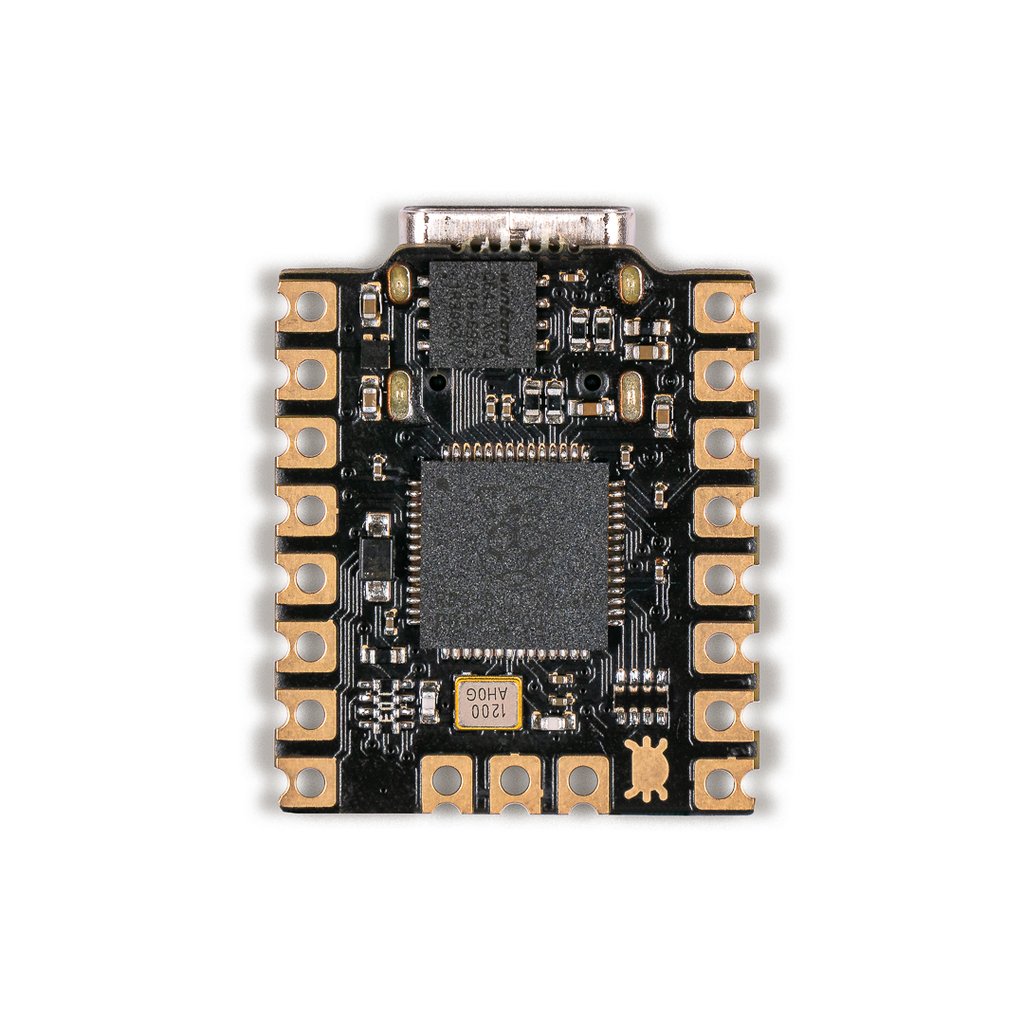

As you’d expect, sacrifices have to be made to enjoy the small form factor. This includes losing half of the I/O pins available on most other boards like the Raspberry Pi Pico, this loss also includes an SPI interface among others. Recording this under losses because it was a personal disappointment for me; despite the fact that the board comes with castellated pins set up, all your plans to use it as an SMD unit is a no-no, as the board has components on both sides which makes reflow operations impossible.
