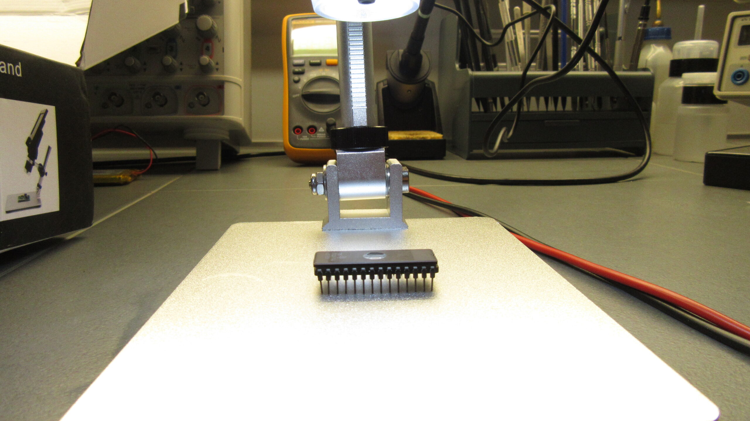

The vertical microscopes (G600) have a serious setback, it is easy to lose sight of the details of the objects due to reflection. Because they are used in many applications such as solder on PCBs, the model designation of some tiny chips and metals requires distinct sight of the details of the objects. However, the G1200 specifically solves this problem because it is an angle-adjustable digital microscope that solves the problem of high reflection. It’s a great experience in the electronics maintenance industry, and it’s important to note that this machine has a larger operable space than the others. It is very convenient to use tweezers, electric soldering iron, and others under this microscope.

The microscope base looks like it’s from aluminum but I am not sure. The build quality is what to expect for a low-priced microscope and we could also notice a left inclination of the base arm, that was not so straight. You can notice that inclination on the photo below and it seems there is no way to adjust this.

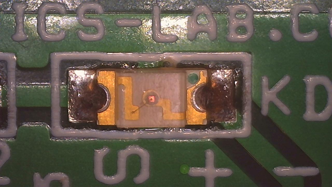

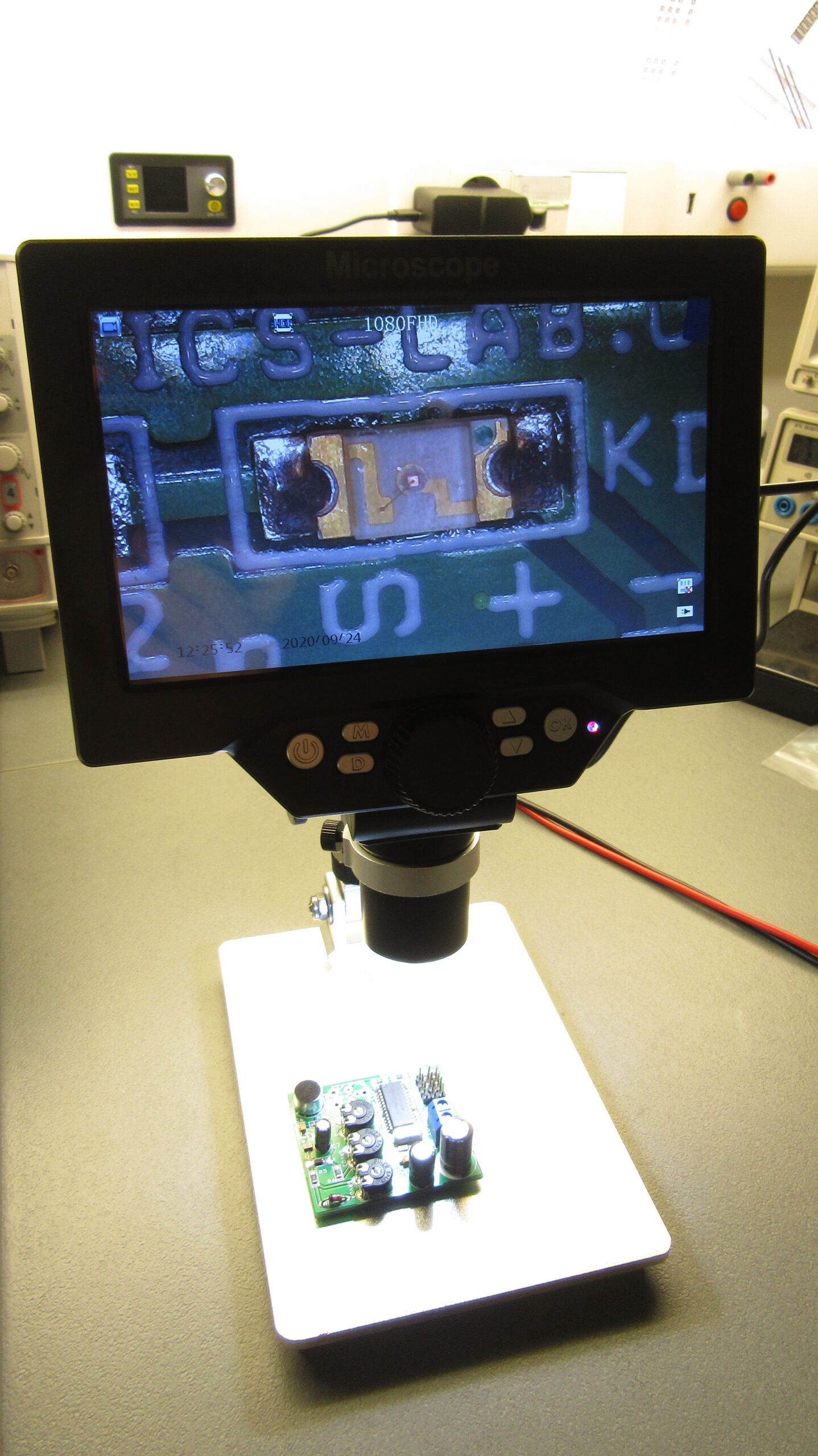

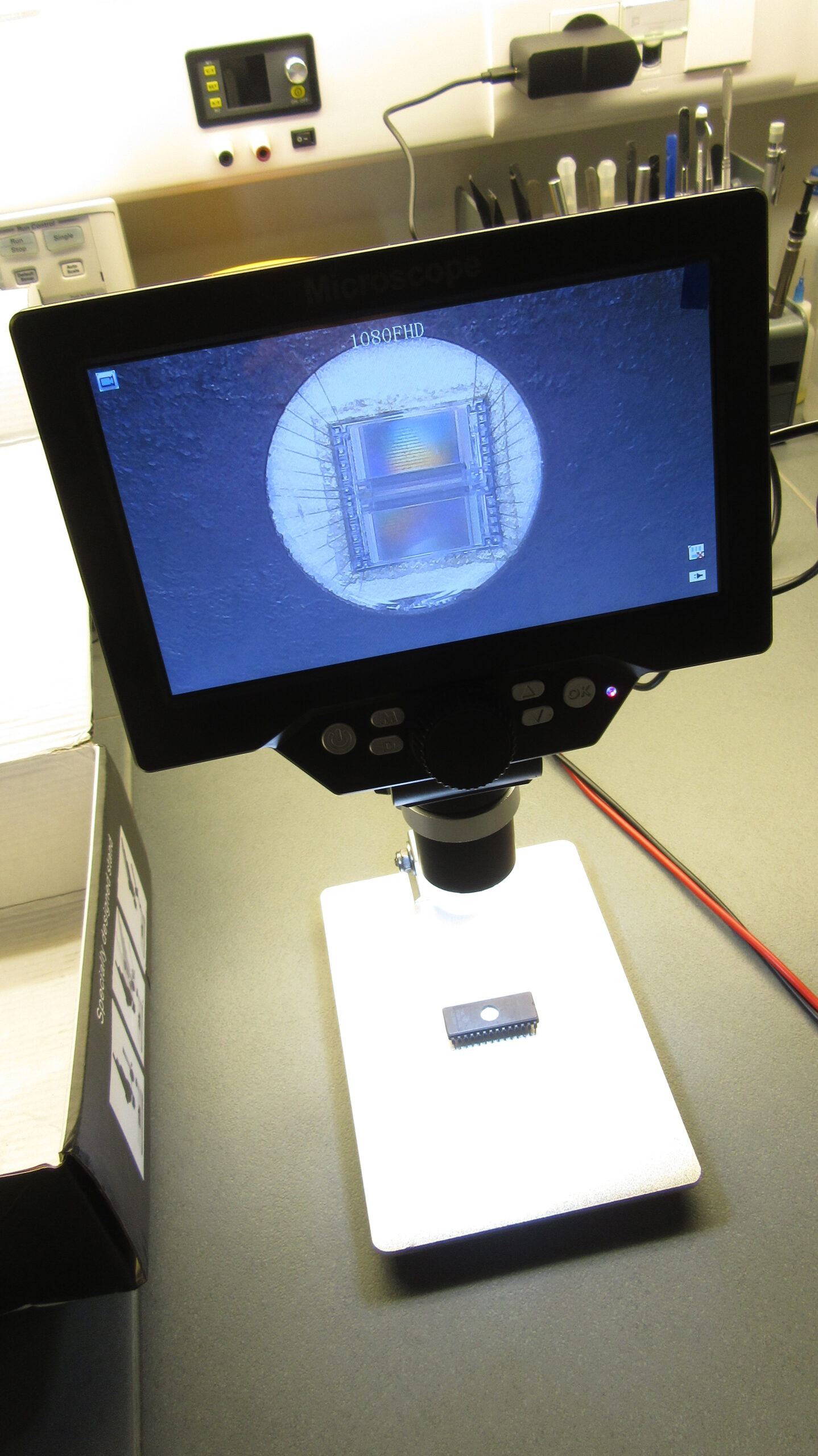

The photo below shows how an SMD LED looks under the microscope. After adjusting the center focus knob, you get the most shard image that is available from the CMOS sensor. In the case of this SMD LED, the focus is good and you can identify small details as there is enough contrast in the scene.

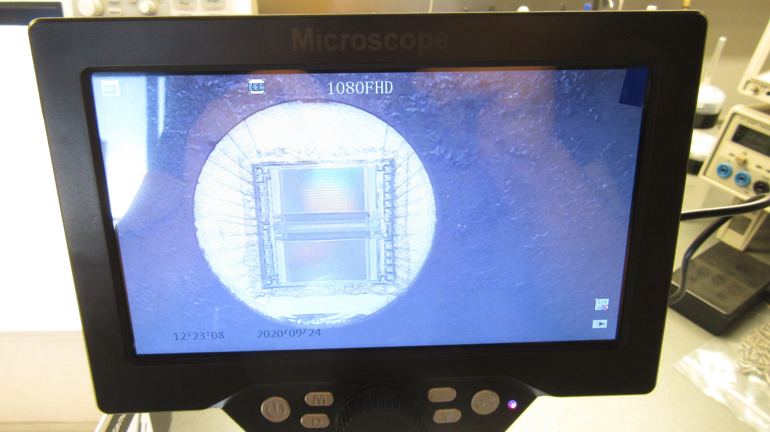

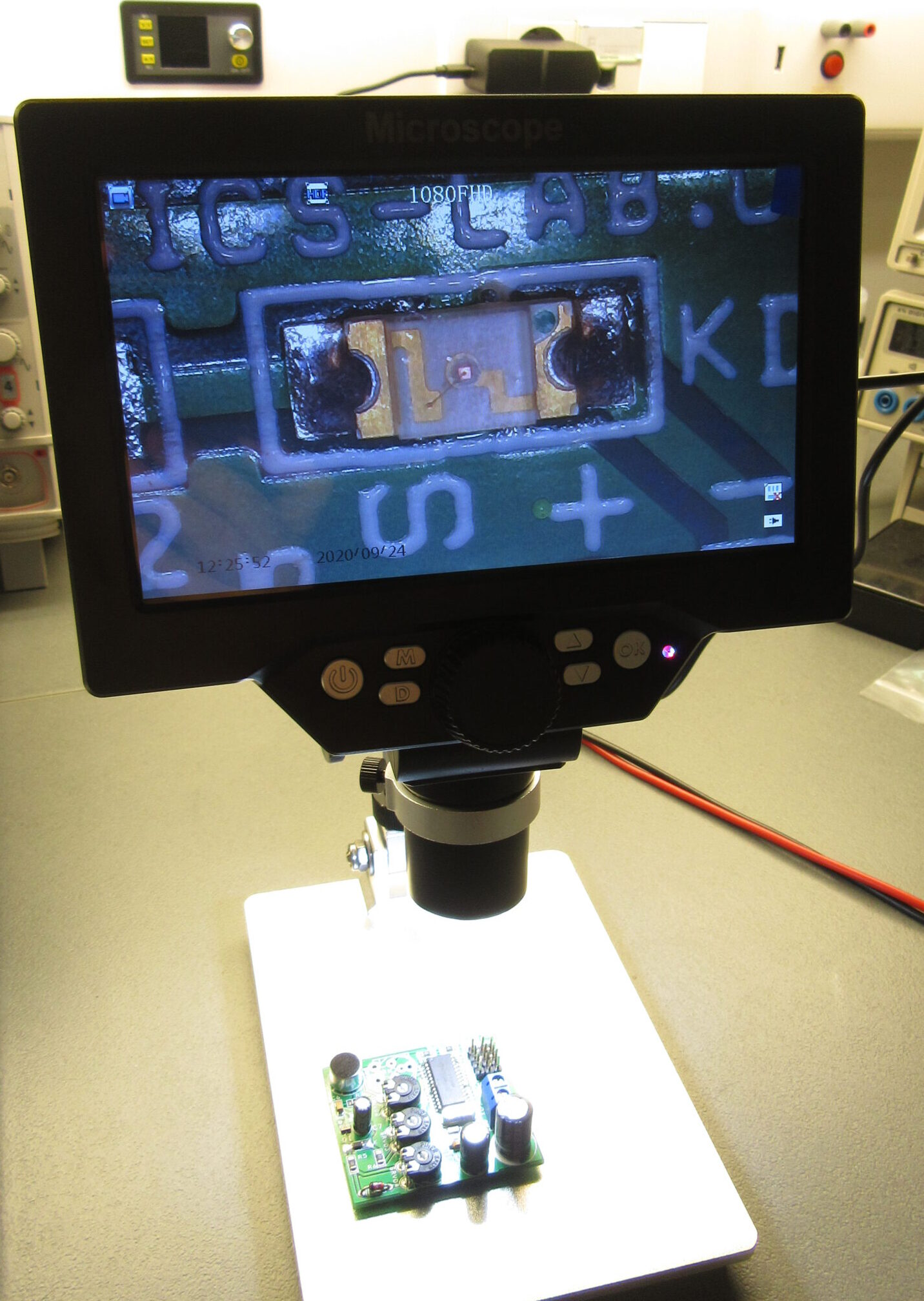

But, when looking at some SMD IC Pins, where the contrast is not very good, you can clearly note that you can’t tell for sure if the pins are soldered or not. In this case, you may have to turn the microscope to another angle to get a better view. This is something that is supported by the available base. Also, it is clearly noted that the LCD contrast is less than enough. We will look just below that the photos captured on the SD card, look much better than the LCD screen.

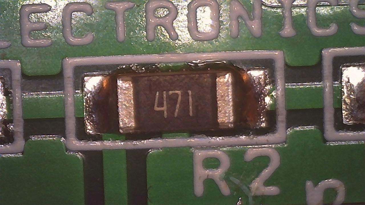

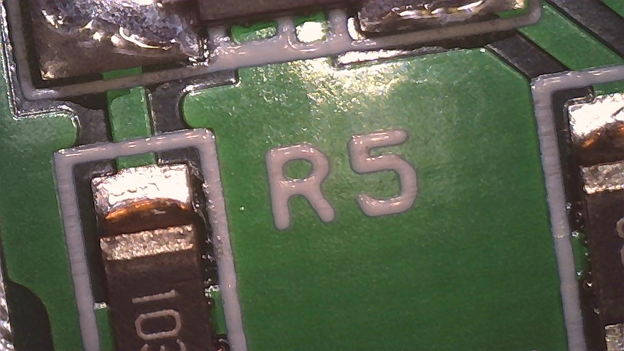

Below you can see some sample captures on the SD card, directly from the microscope. In these photos, you can see the real capabilities of this microscope. It seems the CMOS sensor has some limitations in terms of image quality, but this is something to expect from a low-end instrument. This may not be a serious issue on some applications but may pose a limit on more detailed tasks, where a sharper and clearer image is needed. The maximum image resolution is 1280x720px and it’s as you see below.
