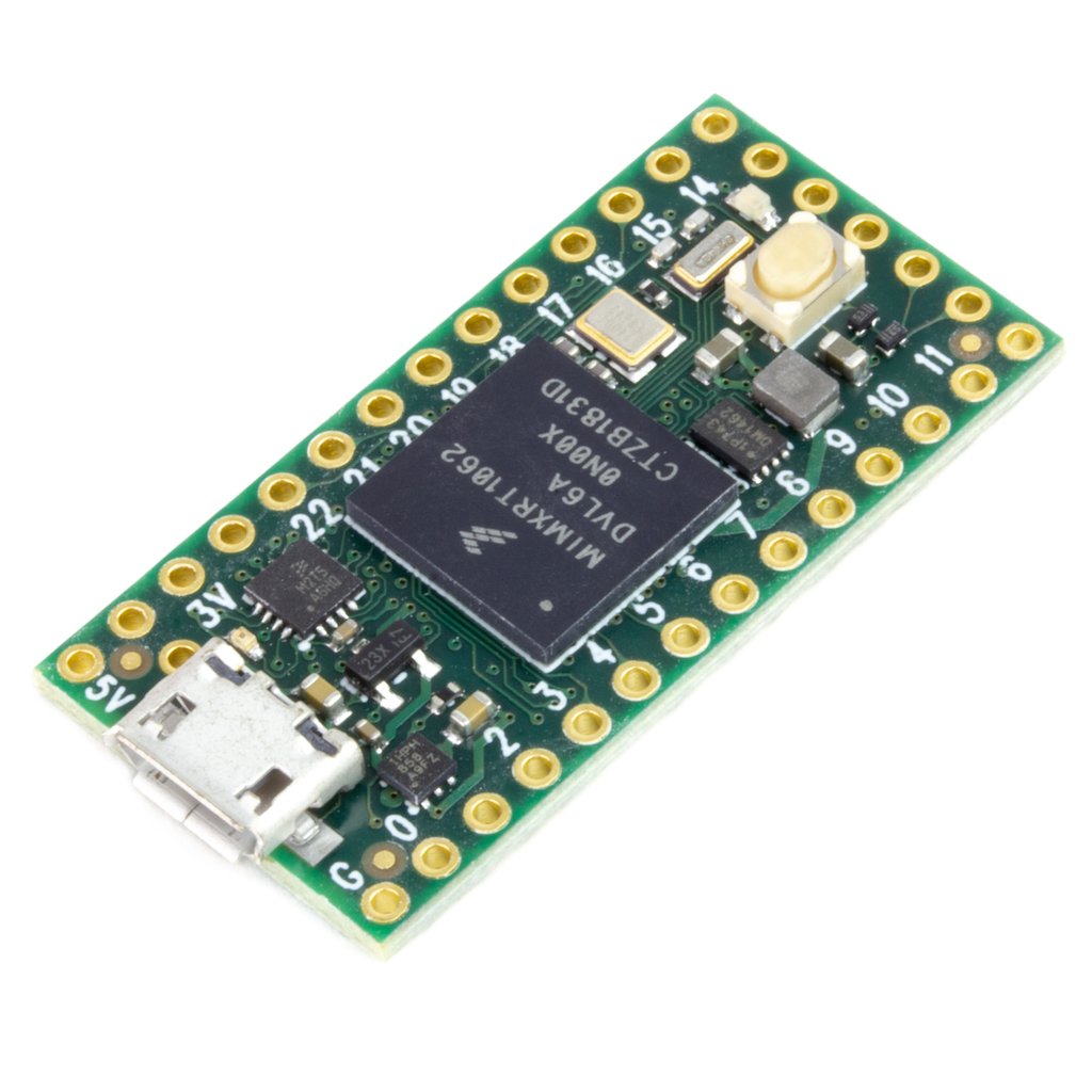

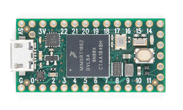

Teensy 4.0 Front view

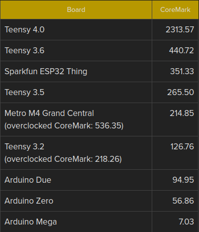

Benchmark Result:
Paul Stoffregen did a benchmark testing with Teensy 4.0 along with Teensy 3.6, Teensy 3.5, Teensy 3.2, ESP32, Metro M4 Grand Central, Arduino Due, Arduino Zero, and Arduino Mega. The benchmark is performed using CoreMark . The synthetic benchmark tests performance managing linked lists, doing matrix multiplies, and executing state machine code. The result clearly shows that Teensy 4.0 outperforms all the other candidates in the test.
CoreMArk benchmark result - higher is better
CoreMark benchmark result – higher is better

joeW
40 IO?
Count the pins in the photo… that does not add up.
