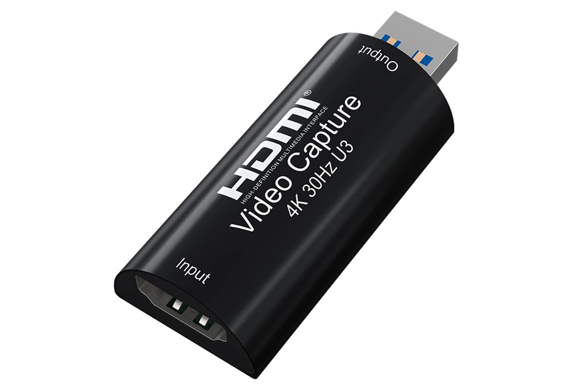

The MS2130 Mini 4K Video Capture Card is a compact and high-quality device designed for capturing HDMI video and audio signals for use on computers or online streaming platforms. It supports input resolutions up to 4K@30Hz and outputs at 1080P@60fps with YUY2 full HD color depth, ensuring sharp, detailed visuals.
The MS2130 Mini 4K Video Capture Card is a compact and high-quality device designed for capturing HDMI video and audio signals for use on computers or online streaming platforms. It supports input resolutions up to 4K@30Hz and outputs at 1080P@60fps with YUY2 full HD color depth, ensuring sharp, detailed visuals. Featuring USB 3.0 connectivity for fast, seamless data transfer, this plug-and-play device is compatible with Windows, MacOS, and Android systems, requiring no additional drivers. Ideal for video recording, live streaming, gaming, teaching, medical imaging, and more, it integrates with popular software like OBS, VLC, and Amcap. Portable and powered via USB, it conforms to UVC and UAC standards, supports stereo audio, and works with HDMI cables up to 15 meters (for 1080P and lower resolutions). The device operates within a temperature range of -10°C to +55°C and has minimal hardware requirements, making it versatile for professional and personal use.

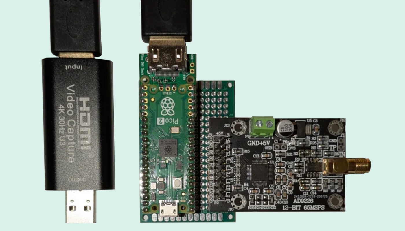

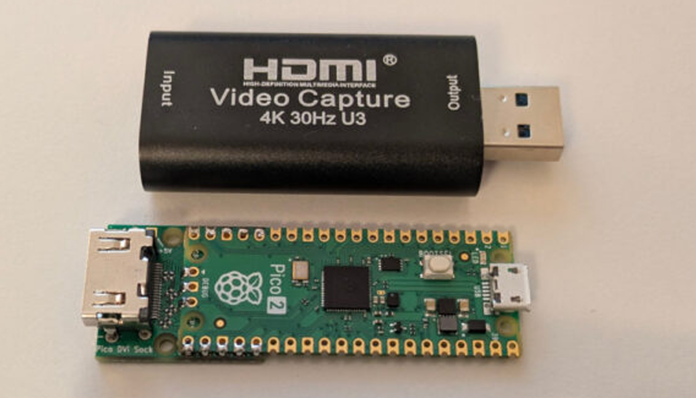

Recently, Steve Markgraf, a Game programmer discovered a new application for the HSTX interface (high-speed data acquisition). By pairing a Raspberry Pi Pico 2 board with the DVI Sock board for Pico and an affordable MS2130-based HDMI to USB 3.0 video capture dongle, he successfully streamed up to 75 MB/s of real-time data from an overclocked RP2350 microcontroller to a USB 3.0-equipped host computer.
The libpicohsdaoh library handles the core functionality. It retrieves data from a ring buffer and transmits it through the HSTX port to the HDMI capture card. Additionally, the project’s GitHub repository includes three example applications in the “apps” folder.

The MS2130 theoretically supports data acquisition speeds of up to 298.5 MB/s, making the Raspberry Pi Pico 2 the limiting factor in this setup. Performance can be enhanced using cost-effective FPGA boards like the Sipeed Tang Mega 138K. Steve also developed an SDR using the same approach and additional hardware to capture data with the open-source Fosphor program. The firmware source and the High-Speed Data Acquisition over HDMI (hsdaoh) userspace library are available on GitHub for various platforms.
The hardware is remarkably affordable, with the Raspberry Pi Pico 2 priced at $4.45 and the MS2130 Mini (4K video capture card) HDMI to USB 3.0 dongle available for around $0.99 on AliExpress (Currently unavailable on Amazon). This basic setup is enough to get started, though additional components, such as the AD9226 12-bit ADC module, which costs around $16.41, will be necessary for building more functional systems.
