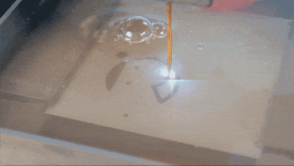

EDM is a process that uses sparks to cut thin lines in hard metals like tool steel, which would be difficult for conventional mills to handle. It is a clean process that does not require powerful motors, as there is no physical contact between the tool and the material, thus requiring very little torque. This makes it suitable for desktop use, as the machine can be small and lightweight. The sparks are created by pulsing electricity between two electrodes with sheet metal in between them, and the electrodes are moved around the material at a relatively slow pace.

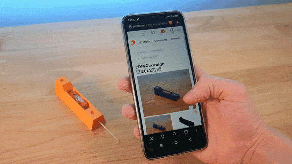

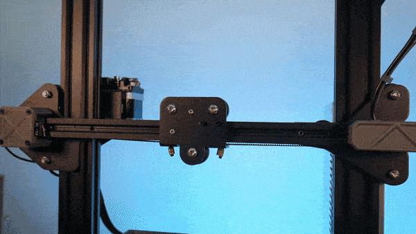

EDM is much more gentle than traditional subtractive manufacturing, making it an attractive option for home labs. Unlike metal-capable CNC mills which require large castings to contain cutting forces, EDM can use light-duty structures and still produce precise parts. Powercore is an example of this, as it is designed to replace the extruder of a 3D printer and is composed of parts that can be printed on the same machine.
EDM is a more attractive option for home labs than traditional subtractive manufacturing due to its gentleness, and it can produce precise parts with light-duty structures, unlike metal-capable CNC mills which require large castings to contain cutting forces. Powercore is designed to replace the extruder of a 3D printer and is composed of parts that can be printed on the same machine.

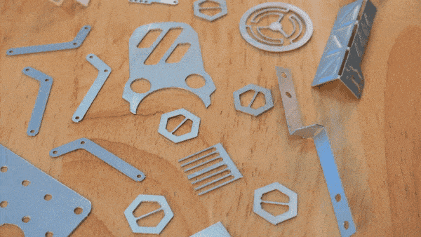

Rack Robotics claims they have been able to cut material as thick as 4mm, but suggest keeping it below 1mm for the small vat with a standard material stock of 3×3″ aluminum sheet. Cut rates are estimated to be around 10mm per minute. Rack Robotics suggests that the Powercore is best suited for cutting small, thin aluminum sheet metal parts that require precise, clean edges, as well as delicate parts that would be difficult to fabricate with conventional methods without damage. It is not suitable for cutting large sheets, very thick sheets, or fast jobs.
