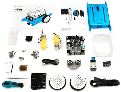

To do this project you need the following tools
fpk3ufsiva4gsly-medium
Mechanical part list
  • 1*Metal Base Plate
  • 2*TT Gear Motor
  • 2*Wheel
  • 2*Tyre
  • 1*Plastic Universal Wheel
  • 1*Magic Tape 20*30mm
  • 6*Brass Stud M4*25
  • 14*Socket Cap Screw M4*8
  • 6*Nut M4
  • 4*Nut M3
  • 4*Philip’s Head Screw M3*25
  • 2*Tapping Screw M2.2*9.5
90053-500x500

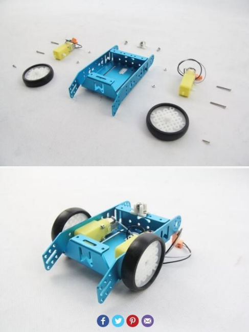

You only have to put each element in the right place and to tighten some screws. The image below shows how to assemble the pieces together.

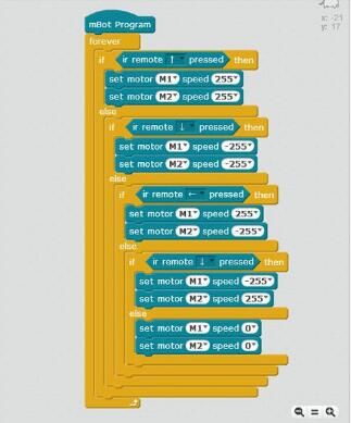

The mBlock is a customized version of scratch. It is easy to use mBlock to interact with electronic modules. To make the project works, you should first program the Control Board (Compatible with Arduino) using this code of mBlock.

You can also program it using Arduino IDE since it makes it easy to write code, upload it to the I/O board, and interact with mBot. Line following is one simple code for controlling the mBot by Infrared Controller.
#include "mBot.h"
#include "MePort.h"
#include "MeIR.h"
#include "MeDCMotor.h"
MeBoard myBoard(mBot);
double angle_rad = PI/180.0;
double angle_deg = 180.0/PI;
MeIR ir;
MeDCMotor motor_9((MEPORT)9);
MeDCMotor motor_10((MEPORT)10);
void setup() {
 ir.begin();
void loop() {
 if(ir.keyPressed(64)){
  motor_9.run(255);
  motor_10.run(255);
 } else {
  if(ir.keyPressed(25)){
   motor_9.run(-255);
   motor_10.run(-255);
  } else {
   if(ir.keyPressed(7)){
    motor_9.run(255);
    motor_10.run(-255);
   } else {
     motor_9.run(-255);
     motor_10.run(255);
    } else {
     motor_9.run(0);
     motor_10.run(0);
 ir.loop();
