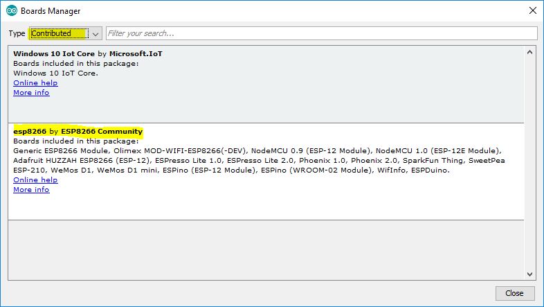

  3. Enter http://arduino.esp8266.com/stable/package_esp8266com_index.json into Additional Board Manager URLs field. (See the first image)
  4. Open Boards Manager from Tools > Board menu and install ESP8266 platform. (See the second image)
Add URL to "Preferences" in Arduino IDE
Add URL to “Preferences” in Arduino IDE (as shown in cover screenshoot)
Select ESP8266 board from Board Manager
Select ESP8266 board from Board Manager (as shown above)

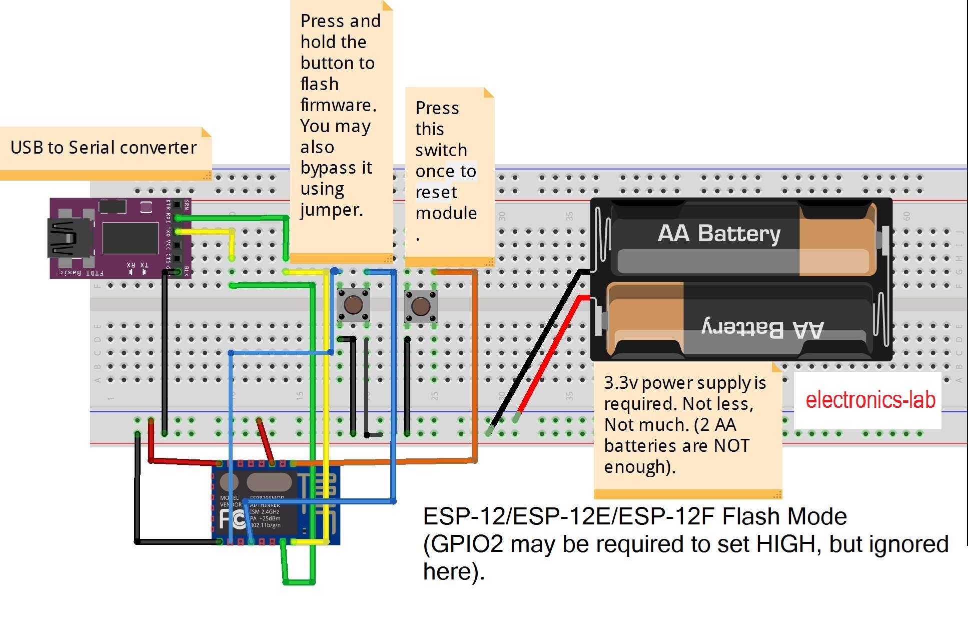

Making The Circuit
ESP8266-01 wiring for uploading program
ESP8266-12E wiring for uploading program
ESP-01:
  1. Connect GPIO0 to Ground (set it LOW or 0)
  2. Connect CH_PD toVcc (set it HIGH or 1)
ESP-12(E/F):
  2. Connect GPIO15 to Ground (set it LOW OR 0)
  3. Connect GPIO2 to Vcc (set it HIGH or 1)
  4. Connect CH_PD toVcc (set it HIGH or 1)
Pin Vcc and GND should be connected to power supply’s +VE and -VE rail respectively. TX and RX of ESP8266 should be connected to RX and TX of USB to TTL converter respectively.
You can replace the USB to TTL converter with an Arduino UNO board, but you have to upload a blank sketch or “bare-minimum” sketch to the Arduino so that the MCU of the Arduino board doesn’t interrupt. Connect TX and RX of the ESP8266 to RX and TX of the Arduino UNO respectively.
