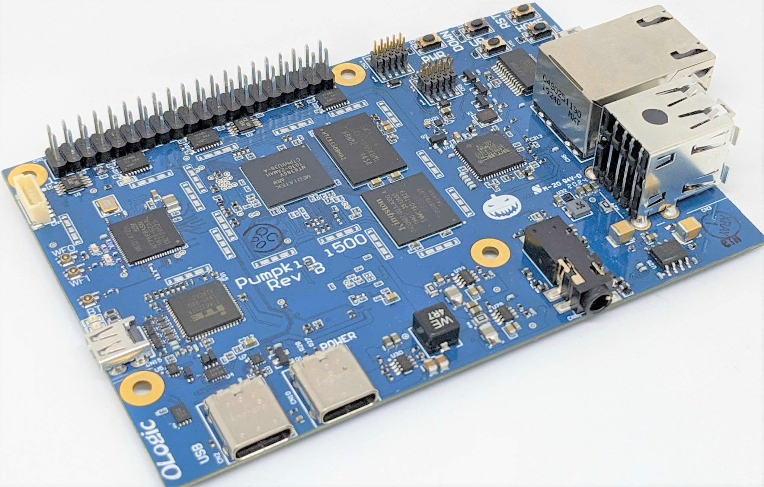

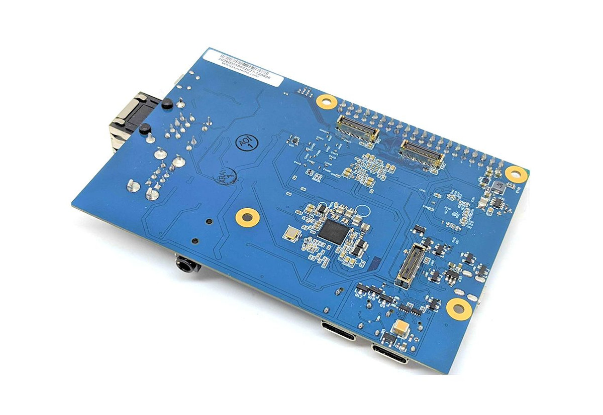

The Pumpkin i500 Evaluation Kit is powered by a powerful MediaTek i500 SoC combined with Quad-core Arm Cortex-A73 and Quad-core Cortex-A53 power-efficient 64-bit CPU solutions together with an Arm Mali-G72 MP3 GPU. The board also features a rich set of GPIO for expandability and a dual-Band Wi-Fi (2.4GHz/ 5GHz) and Bluetooth 5 that make it suitable for indoor/outdoor home and industrial applications.
Features and Specifications of the Pumpkin i500 SBC include:
  • CPU: MediaTek i500 octa-core processor with quad-core Arm Cortex-A73 running at up to 2.0 GHz and quad-core Cortex-A53 cores at 2.0 GHz
  • GPU: Arm Mali-G72 MP3
  • Dual-core Tensilica Vision P6 DSP/AI accelerator @ 525 MHz
  • Upgradable 2GB LPDDR4 RAM
  • 16GB eMMC flash
  • 4-lane MIPI DSI connector
  • Up to 25MP camera support via MIPI CSI connector
  • 3.5mm stereo headset jack
  • 2x Digital PDM microphone connectors
  • 8-ch audio input / 8-ch audio output
  • 1080p60 H.264 video decoder
  • 1080p30 H.264 encoder
  • 10/100M Ethernet (RJ45)
  • Wi-Fi 5 (802.11ac) 2×2 MIMO dual-band (2.4GHz, 5GHz) and Bluetooth 5 for wireless connectivity
  • 1x USB-C OTG port
  • 2x USB-A host ports
  • Micro USB port for debugging
  • 40-pin GPIO connector
  • 5V DC via one USB-C port, and,
  • Support for TensorFlow Lite and Object detection (MobileNet + SSD)
  • Security Features: Secure Boot, Trust Zone, TF-A, OP-TEE
  • Operating System: Yocto Linux and Android 10
