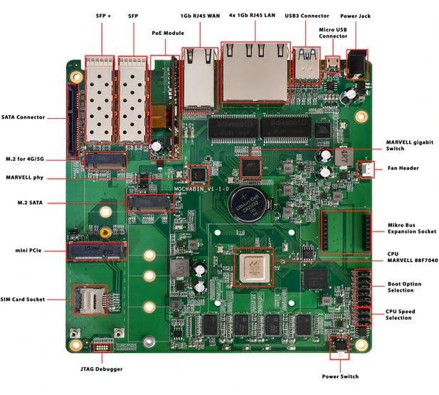

Features and Specifications of the Mochabin-5G include:
  • Marvell Armada 7040 quad-core Corex-A72 processor @ up to 1.4GHz
  • 4GB or 8GB DDR4 (with optional soldering)
  • 16GB eMMC flash
  • 4MB SPI NOR flash for bootloader
  • SATA interface
  • M.2 2280 socket for SATA III SSD
  • 1x 10GbE SFP+, 1x 1GbE SFP (via 88E1512 PHY)
  • 4x Gigabit Ethernet RJ45 LAN ports via Topaz 88E6141 switch
  • 1x Gigabit Ethernet RJ45 WAN port with PoE support
  • Optional 4G or 5G cellular connectivity via M.2 2250 socket plus SIM card slot
  • Optional NXP 88Q9098 based Mini PCIe wireless card for 802.11ax WiFi 6 and Bluetooth 5
  • 2x USB 3.0
  • 16-pin MikroBUS header for GPS, and other expansion and accessories
  • Microchip ATECC608B secure element
  • 10-pin JTAG header
  • Micro USB port for serial console
  • Power button
  • RTC with CR2032 battery holder
  • 12V fan header
  • Various LEDs, boot and CPU speed selection jumpers
  • Power Supply: 12V DC or PoE
  • Dimensions: TBD
