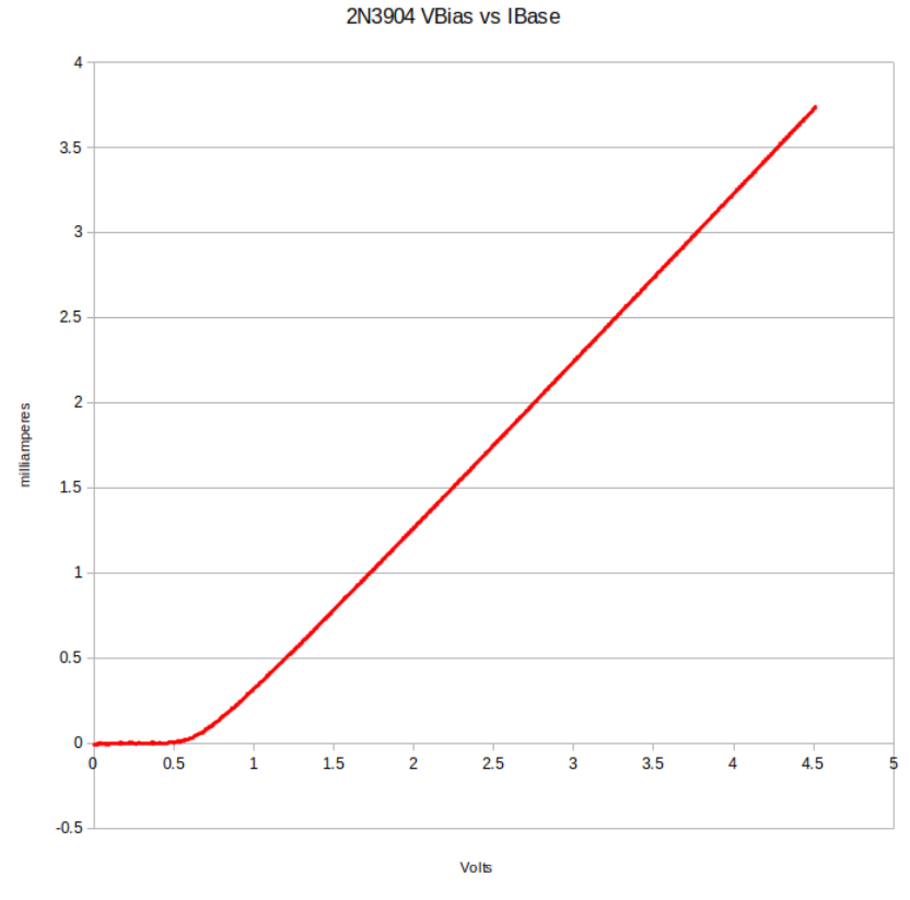

He started by plotting Vbias against the base current. This is the result:

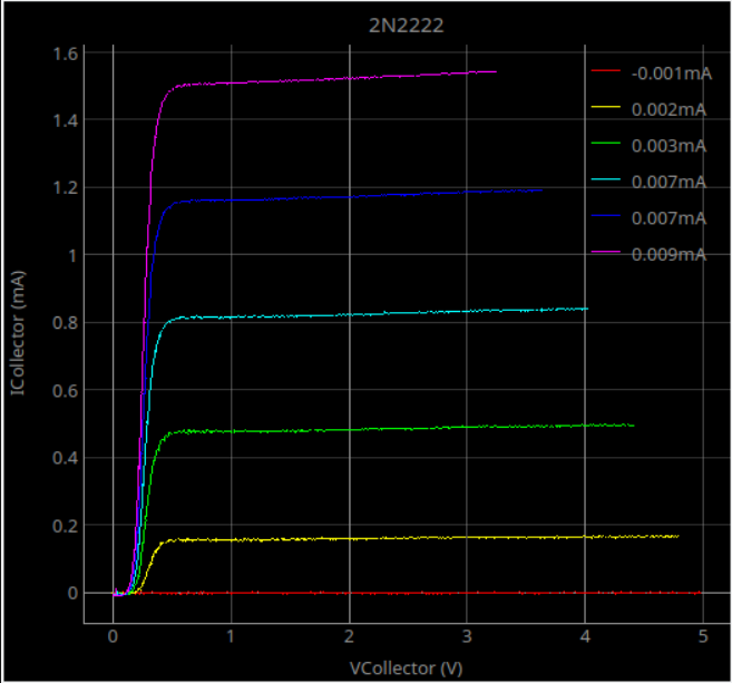

After successfully plotting Vbias, He realized that he had solved all of the problems involved in making a current/voltage tracer for transistors. He made use of Current/voltage traces to design the transistor amplifiers using the load line method of design. This is what current/voltage plot of a typical transistor looks like:

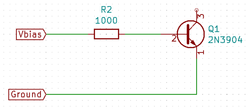

Rodriguez boasts of the simplicity of its circuit. You only need two capacitors, 5 resistors, and an Arduino of any flavor. It is easy to assemble. About the assembly of Rodriguez, he says
“I built mine as a sort of 3D sculpture on the pin header of the Nano.  It could just as easily be assembled on a solderless breadboard.  Perfboard would work as well.  An etched PCB would be rather overkill, but whatever floats your boat.”
You can find the software on github repository, which also includes a schematic of the required circuit and the Arduino program.
For now, Rodriguez can make current/voltage plots of bipolar junction transistors and diodes, which he tested on 2N3904, 2N3906, and 2N2222 transistors.  He also used it on LEDs of various colors, as well as regular diodes (1N4148, 1N4001.) for future upgrades, he says

Rodriguez is quite limited in the current and voltage it can deliver to the device under test.  You can’t get more than 5 volts or about 5 milliamperes out of it.  That’s enough for testing small signal diodes and small transistors.  You won’t be designing a class A power amplifier with Rodriguez, but it will do for learning the principles of amplifier design using the load line method.
