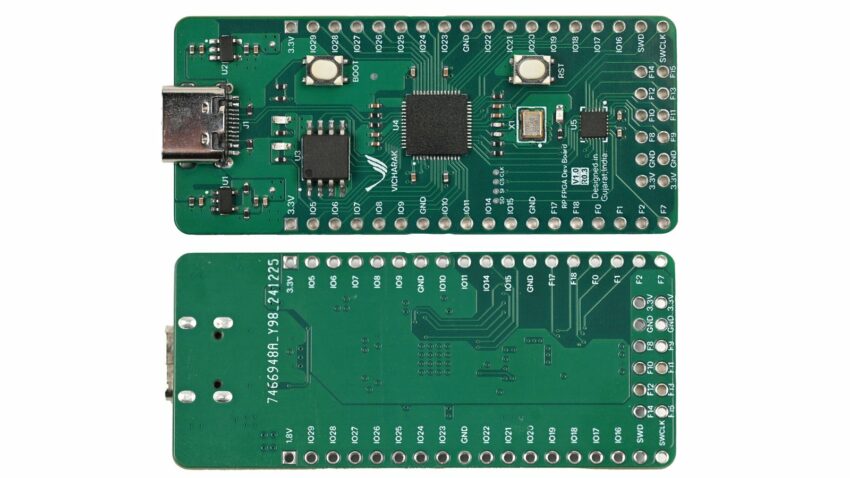

The Shrike is a compact, low-cost, open-source FPGA development board designed by an Indian company, Vicharak, for educational, experimental, and embedded development. It combines a Renesas ForgeFPGA SLG47910V with a Raspberry Pi RP2040 microcontroller, thanks to a six-bit high-speed bridge.

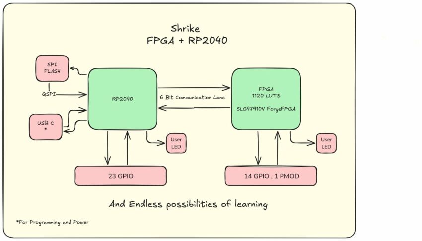

The development board is breadboard-friendly and gets powered/programmed via USB Type-C. The board also offers 23 GPIOs from the RP2040, 14 GPIOs, and a PMOD connector from the FPGA, and includes user-programmable LEDs for status indication. Additionally, there is a quad-SPI flash for the MCU, which can be programmed with MicroPython. These features make this device suitable for students, hobbyists, and embedded developers.

  • MCU-FPGA Interface:
    • 6-bit high-speed parallel bridge between RP2040 and FPGA
