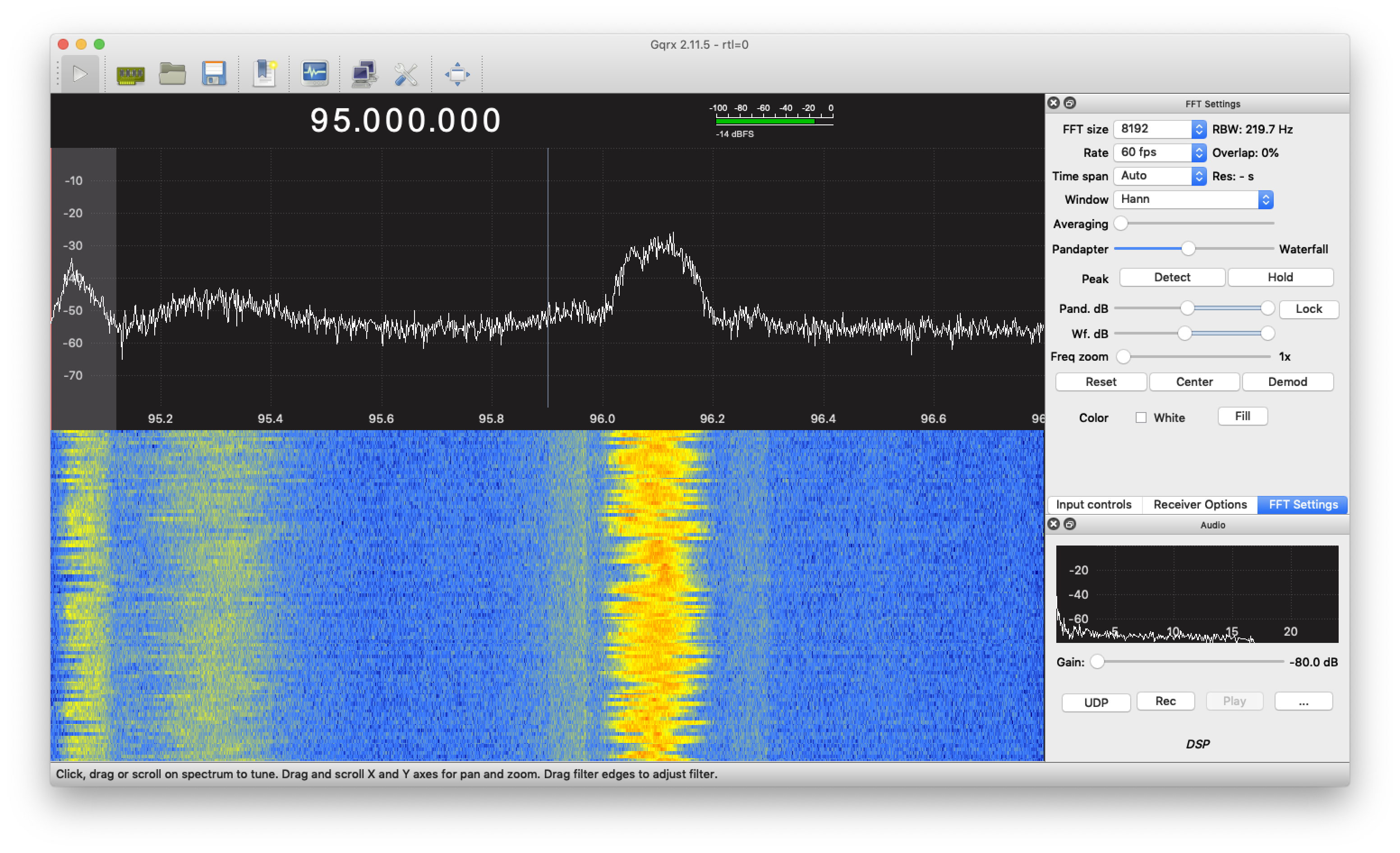

“The tags convert and then broadcast this energy as radio frequency (RF) waves, acting like small radio stations. Each tag is given a unique frequency, allowing for recognition of many simultaneous events. Importantly, we selected a frequency range that readily penetrates common building construction types, offering whole-building sensing with just a single antenna,”

Sozu Tag Frequency
