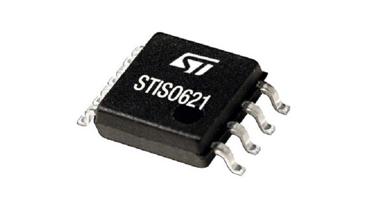

STMicroelectronics STISO621 dual channel digital isolator
The STISO621 are dual-channel digital isolators based on the ST thick oxide galvanic isolation technology The STISO621 are dual-channel digital isolators based on the ST thick oxide galvanic isolation technology. The devices provide two independent channels in opposite direction with Schmitt trigger input, providing robustness to noise and high speed input/output switching time.
Key features
  • 6 kV galvanic isolation
  • High data rate up to 100 Mbps
  • Wide Ta range operation: from -40 ºC to 125 ºC
  • High common-mode transient: > 50 kV/µs
Additional features
  • Dual-channel, digital isolator with 1 – 1 channel directionality
  • Wide Ta range operation: -40 ºC to 125 ºC
  • High common-mode transient: >50k V/µs
  • From 3 V to 5.5 V supply levels
  • 3.3 V and 5 V level translation
  • Low power consumption
  • Pulse width distortions < 3 ns
  • SO8 narrow and wide package options
