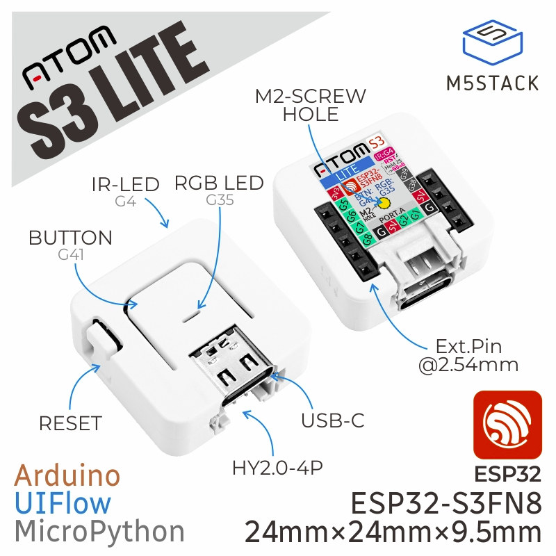

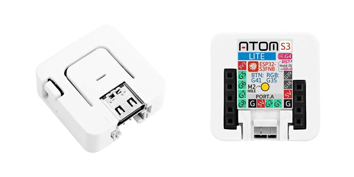

The M5Stack ATOM S3 Lite has an ESP32-S3FN8 WiFi and Bluetooth System-on-Chip (SoC) with 8MB SPI flash, an infrared transmitter, a USB-C port for power and programming, a few I/O pins, user and resets buttons, and it all fits into a housing that is only 24 x 24 mm and 9.5 mm thick.
Specifications
  • It includes a dual-core 32-bit Xtensa LX7 microcontroller from Espressif Systems with AI vector instructions up to 240 MHz, a RISC-V ULP co-processor, 512 KB SRAM, 2.4GHz WiFi 4 (802.11b/g/n), Bluetooth 5.0 BLE + Mesh, and 8 MB flash memory.
  • It has a “3D” antenna built right in.
  • In addition, an extension for 9x pins is provided, complete with GPIOs G5, G6, G7, G8, G38, and G39, as well as 5V, 3.3V, and GND, and a connector for Grove with four pins.
  • In addition to that, there is an infrared LED (transmitter/blaster), a WS2812B-2020 RGB LED with user buttons, and a reset button.
  • It has a screw hole for an M.2 screw already installed.
  • A power supply of approximately 5V is available via the USB Type-C port, and an SY8089 5V to 3V DCDC converter is also included.
  • The temperature range is from 0 to 40 degrees Celsius, and the dimensions are 24 by 24 by 9.5 millimeters. It weighs approximately 5.3 grams.
