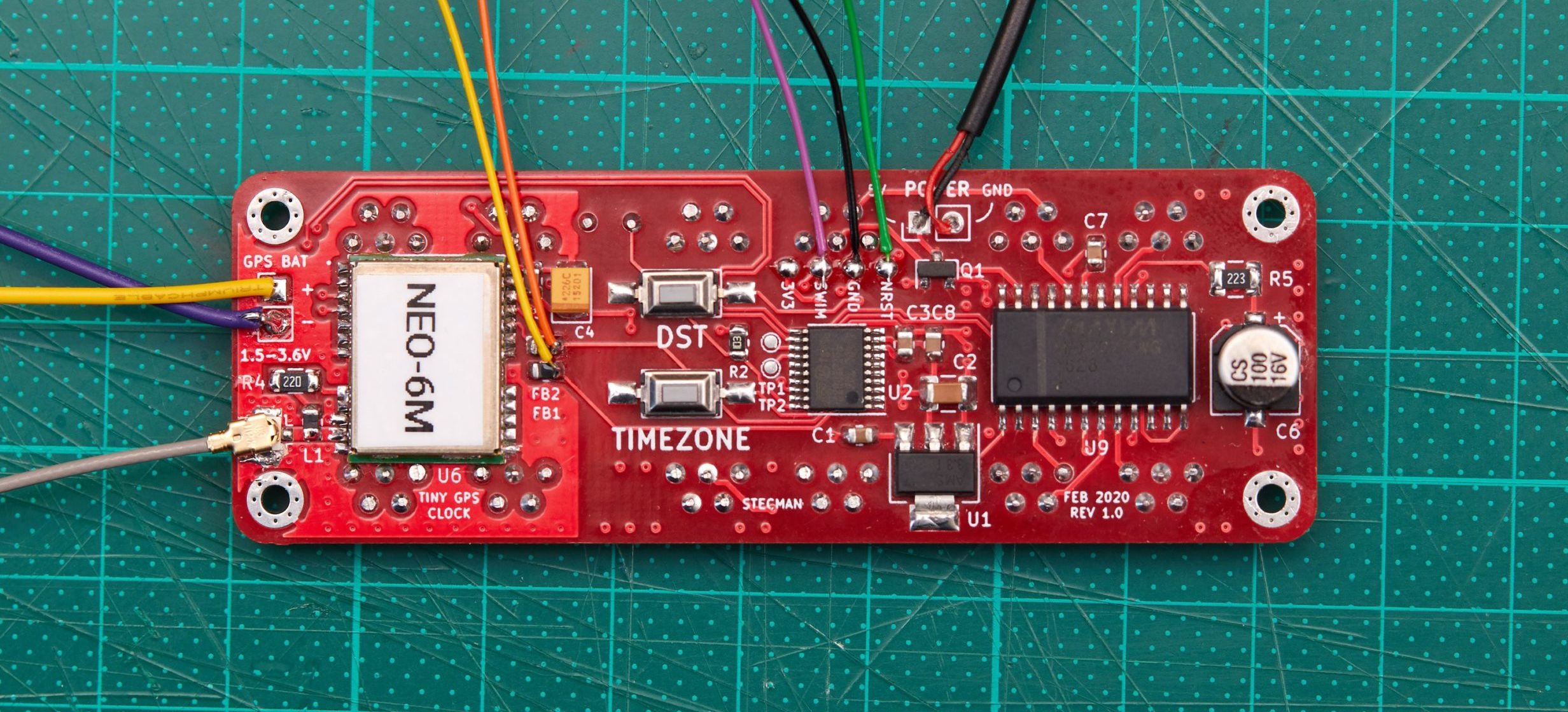

Compared to earlier designs, the GPS-driven clock was built with better functionalities in mind: better display accuracy, more buttons, less pin-sharing, GPS module configuration, etc. It replaces the ATMega88PA with a physically smaller but comparable 8-BIT STM8S003F3P6 microcontroller and integrates the GPS module into the layout instead of a separate breakout board. Offsets are also configured in the GPS module to explain electrical and processing delays in its display.
According to him, the module comes with an attached back-up battery to handle possible cold starts when briefly removing power. The power input is 5V with simple polarity protection and can be regulated to 3.3V for the STM8 and GPS module.
“To get the clock up and running quickly, I ported the code from the original AVR project to run on the STM8. This only required swapping out a few registers and pin mappings, replacing the SPI, UART, and ADC implementations, and adding mapping to set BCD values on the common-anode wiring of the MAX72XX. The board went to fab Mid-February, was manufactured over the course of 10days, and took a further 10 days to get to my bench in New Zealand”
