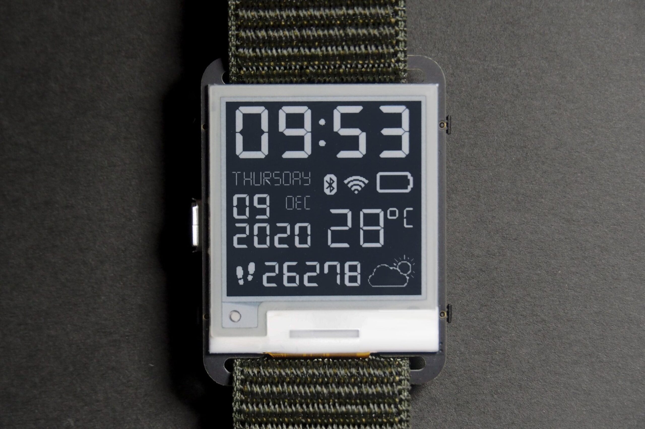

Watchy seems to be a closer resemblance to Pebble-like smartwatches, but instead of a full-color OLED display, it comes with a monochromatic 1.54-inch e-paper display. The screen has a resolution of 200 x 200 pixels and is offcource low power. Hence, this makes the Watchy smartwatch readable from different viewing angles. Although, it has one drawback that it does not include a backlight or sidelight for seeing time in the dark.

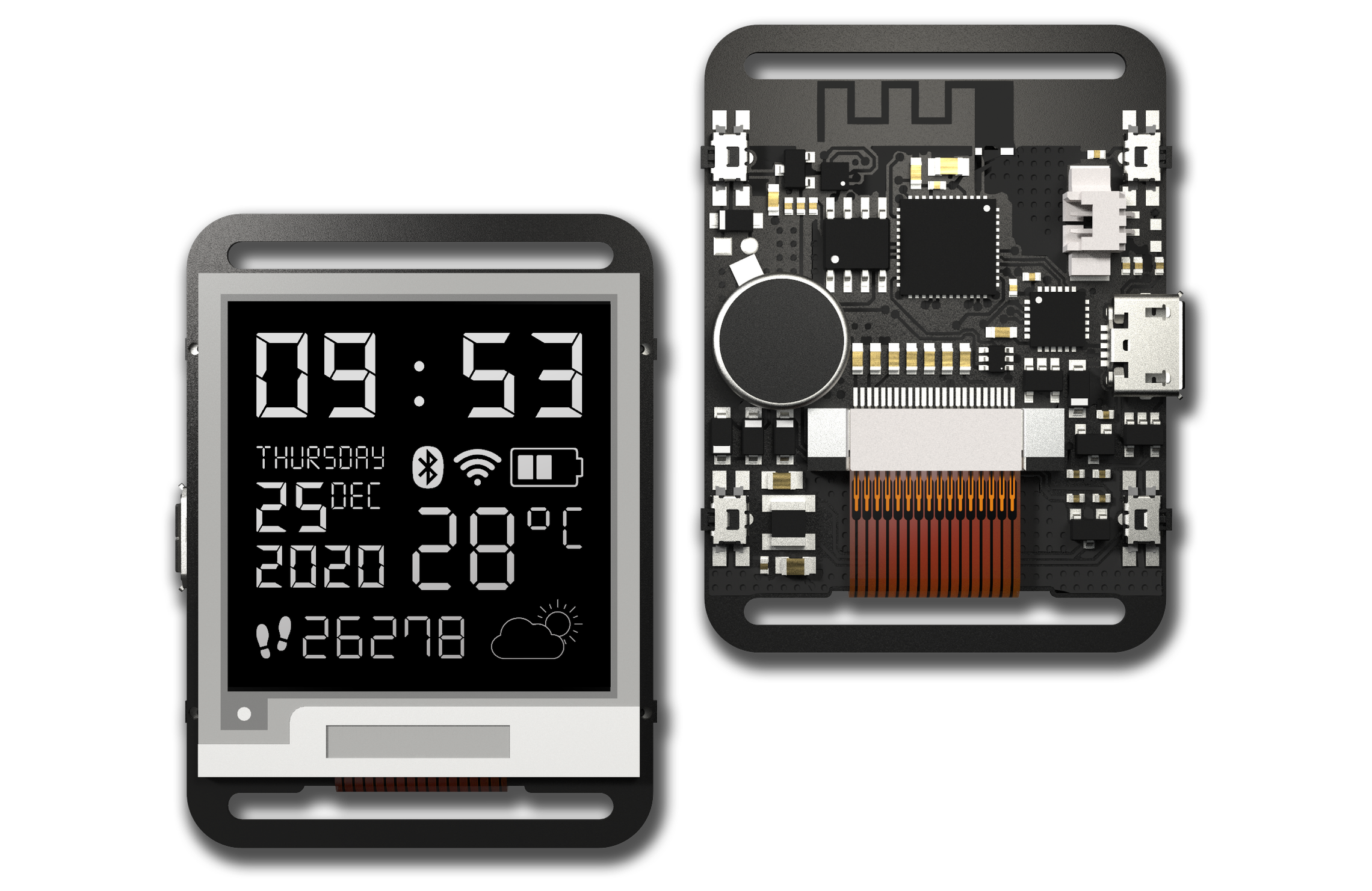

Key Features of Watchy Smartwatch:
  • Microcontroller ESP32-PICO-D4
  • USB-Serial CP2104
  • E-Paper Display GDEH0154D67
  • Display Connector AFC07-S24ECC-00
  • 3-Axis Accelerometer BMA423
  • Real-Time Clock DS3231
  • Battery LiPo Battery 3.7V 200mAh 402030
  • LDO Voltage Regulator ME6211C33M5G-N
  • Battery Connector BOOMELE 1.25T-2PWT
  • Micro USB Connector U-F-M5DD-Y-L
  • Tactile Buttons K2-1114SA-A4SW-06
  • Vibration Motor 1020
  • PCB Antenna SWRA117D
Watchy comes with Espressif Systems ESP32-PICO-D4 system-in-package with ESP32 dual-core processor with Bluetooth LE 4.2/5.x and WiFi 4 connectivity. It also features wide viewing angles and 4MB SPI flash for interfacing. BMA423 is the 3-axis accelerometer functioning as a sensor for gesture detection and activity tracking. Talking about the power specification, it has a 200 mAh battery fit for 5-7 days for timekeeping provided without WiFi. Whereas with a WiFi connection it can only last 2-3 days.
