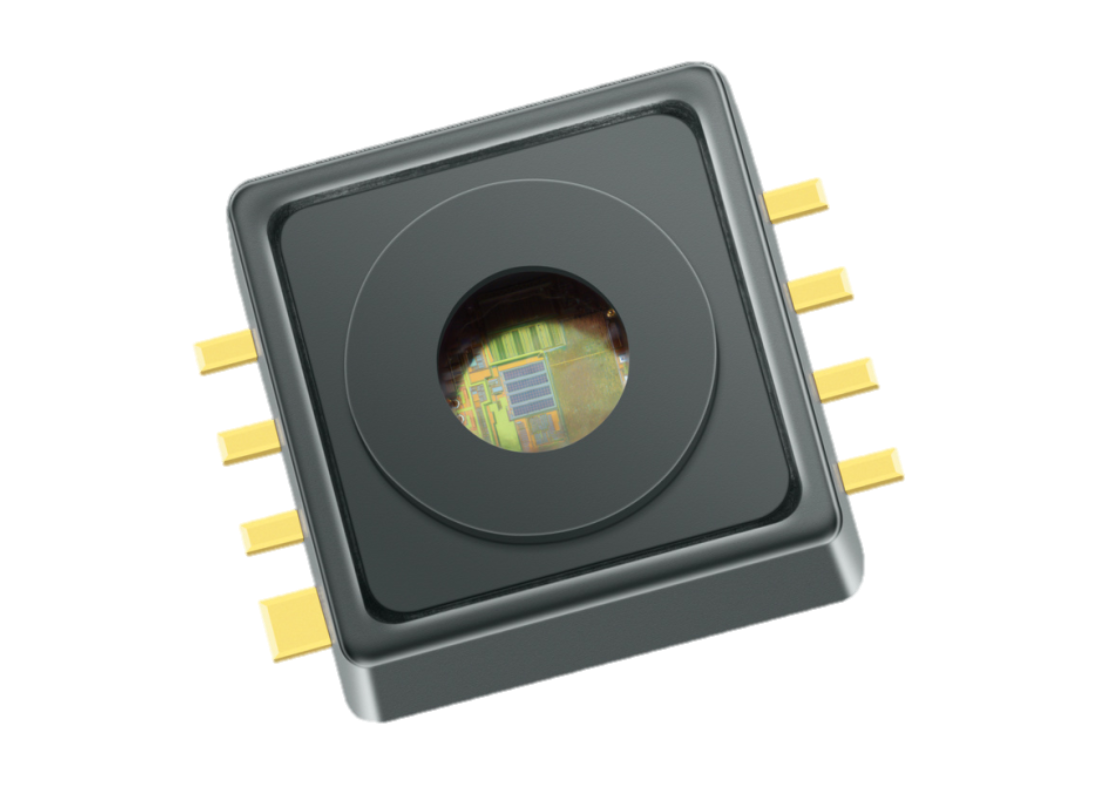

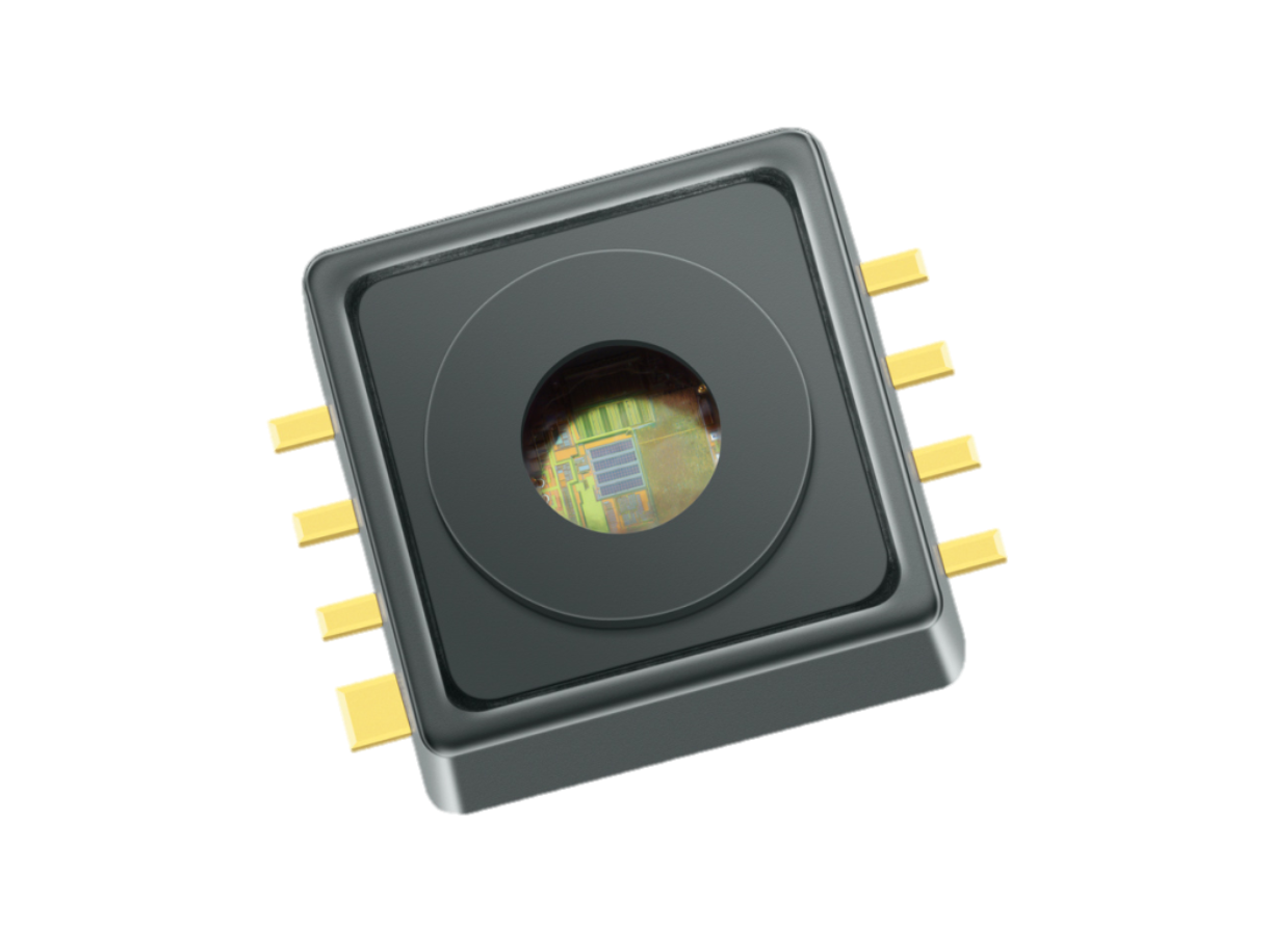

The Infineon manifold air pressure (MAP) sensor family is growing by adding two analog MAP sensors the KP212F1701 and KP212K1409, both dedicated for the two-wheeler market. Just like all other XENSIV™ MAP sensor families, KP212 features its proven high quality with a DPM rate lower than 0.3 DPM. These automotive-qualified analog pressure sensors are characterized by their high-precision pressure sensing: ±1.4 kPa at KP212F1701. The sensors offer dedicated transfer functions for two-wheelers.
XENSIV KP212F1701 Features
  • High-precision pressure sensing (±1.4 kPa)
  • Ratiometric analog output
  • Large temperature range: -40°C to +125°C
  • Broken wire detection
  • Clamping
  • Green 8 pin SMD housing, PG-DSOF-8-16
  • Automotive qualified, AEC-Q100
