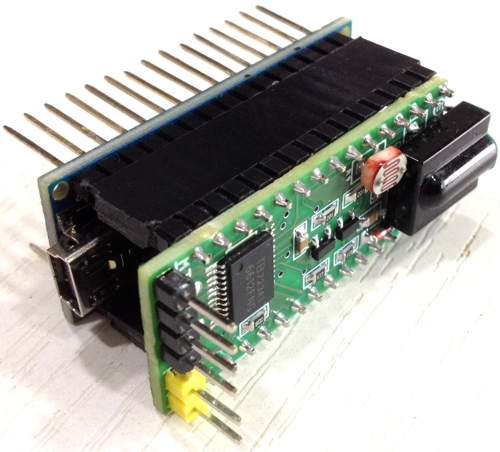

This Arduino shield helps to drive various loads like a solenoid, valve, motor, inductive actuator, heater, and bulb. A wide supply range 8V-60V and a load current of 2.7A allows it to be used with a variety of actuators.
Arduino by mixos
This Arduino shield helps to drive various loads like a solenoid, valve, motor, inductive actuator, heater, and bulb. A wide supply range 8V-60V and a load current of 2.7A allows it to be used with a variety of actuators. The board can be used as a stand-alone driver or it can be controlled by Arduino Nano. DRV102 is the heart of the project which is a high-side power switch employing a pulse-width modulated (PWM) output. Its rugged design is optimized for driving electromechanical devices such as valves, solenoids, relays, actuators, and positioners. The circuit is also ideal for driving thermal devices such as heaters and lamps. PWM operation conserves power and reduces heat rise in the device, resulting in higher reliability.
