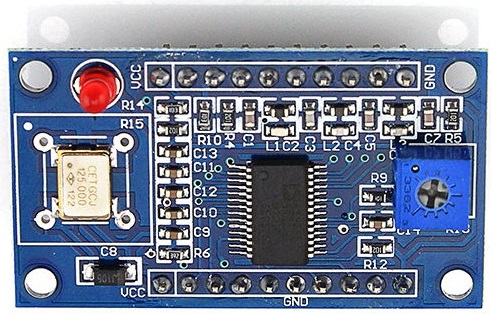

The AD9850 is a CMOS highly integrated device that uses advanced Direct Digital Synthesis (DDS) technology coupled with an internal high speed, high performance, D/A converter and comparator, to form a complete digitally programmable frequency synthesizer and clock generator function.
dds_moduleAD9850 module is a $9 stable, low drift VFO (Variable Frequency Oscillator) fed by a 125 MHz crystal clock. The module covers from 0 to 40 MHz, which are all the HAM HF(High Frequency) frequencies. There are 4 output pins on the device, 2 for Sine Waves (only one Frequency at a time) and two Square wave outputs. The blue pot on the board adjusts the duty cycle of the Square Wave Outputs but has no effect on the Sine Wave Outputs.
AD9850 features:
  • Signal Frequency output range: 0-40MHz
  • 4 Signal outputs; 2 sine wave outputs and 2 square wave outputs
  • DAC SFDR > 50 dB @ 40 MHz AOUT
  • 32-Bit Frequency Tuning Word
  • Simplified Control Interface: Parallel Byte or Serial Loading Format
  • Phase Modulation Capability
  • +3.3 V or +5 V Single Supply Operation
  • Low Power: 380 mW @ 125 MHz (+5 V)
  • Low Power: 155 mW @ 110 MHz (+3.3 V)
  • Power-Down Function
