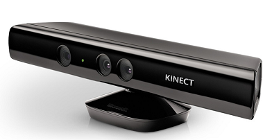

ic568992The Kinect sensor is a horizontal bar of motion sensing input devices which enable users to control and interact with their computers through a natural user interface using gestures and spoken commands.
The sensor consists of a RGB camera, depth sensor, and multi-array microphone running proprietary software. It provides full-body 3D motion capture, facial recognition, and voice recognition capabilities.

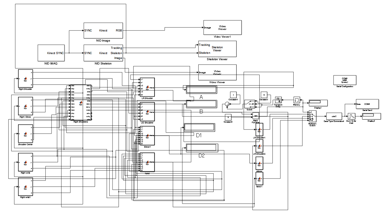

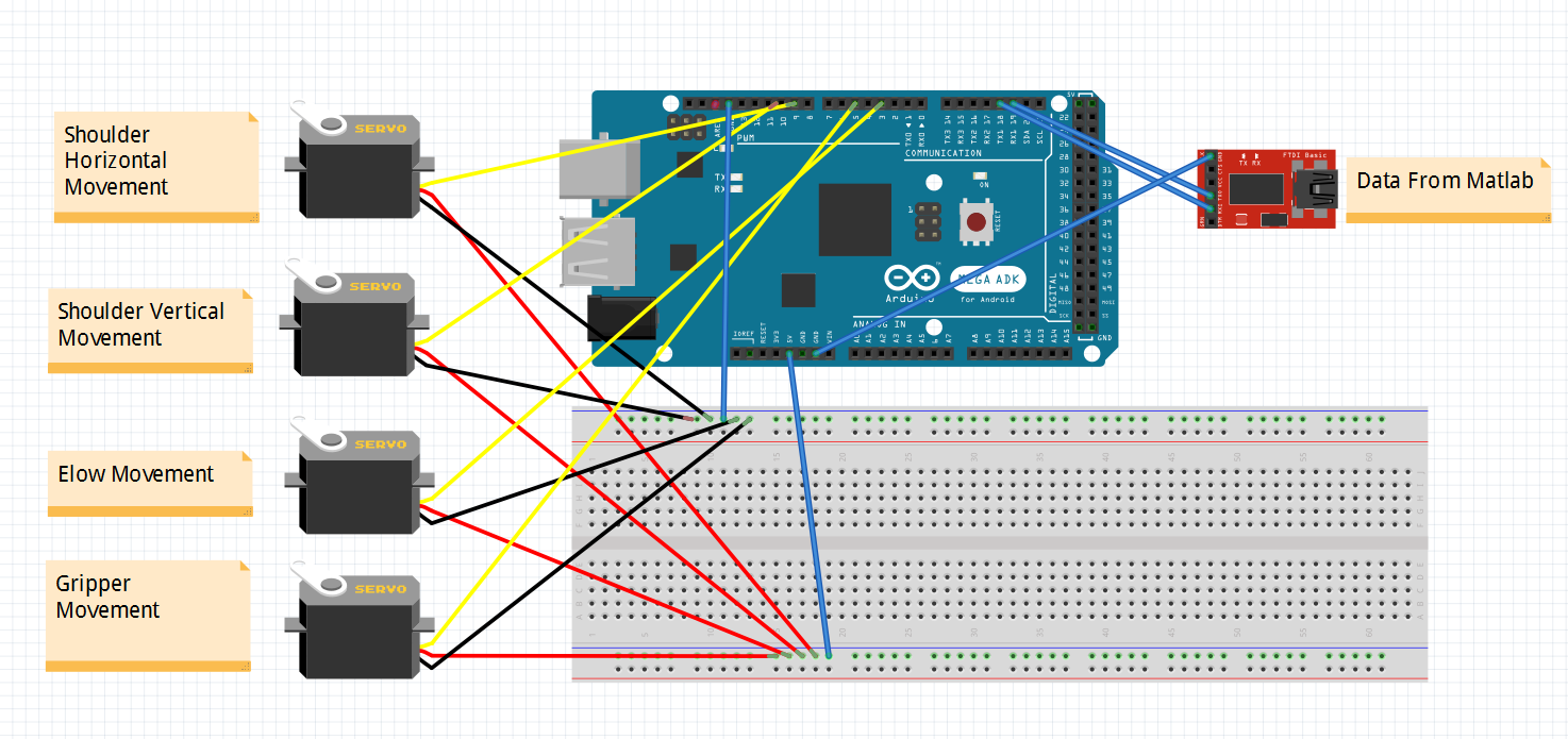

Thanks to Simulink support for Kinect, the computer collects data from the connected kinect device and translates them into servo angles in MATLAB. These angles are sent to the servos through the arduino via TTL device, resulting movement of the arm with a slight delay.
TTL - Arduino & Arduino - Servo Connection Schematic
TTL – Arduino & Arduino – Servo Connection Schematic
Simulink Model
Simulink Model
