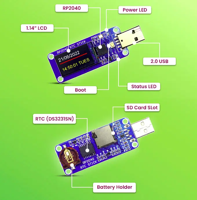

Combined with the power of the low-cost high-performance RP2040 microcontroller, EncroPi is, no doubt, a lightning-fast and extremely reliable product designed to help you in your projects seamlessly. The microcontroller has two ARM Cortex-M0+ cores @ 133 MHz, 264KB SRAM, and large on-chip memory. There’s also a microSD card slot, an onboard display, a coin cell battery holder for RTC devices, and the ability to automatically switch to a backup coin cell supply in the advent of a power outage.

Specifications include:
  • Raspberry Pi RP2040 dual-core Cortex-M0+ microcontroller @ 133 MHz with 264KB SRAM
  • IC module DS3231 RTC functions as a clock-setter in the product.
  • QSPI flash
  • MicroSD card slot
  • 1x USB 2.0 Type-A or Type-C port
  • 1.14-inch LCD with 240×240 resolution
  • Onboard boot button to upload the firmware
  • Power and Status LED
  • Battery Holder with button cell for power backup of DS321
  • Separate SD card slot for storing the data you want to run on the device
  • Power Supply: 5V via USB port
