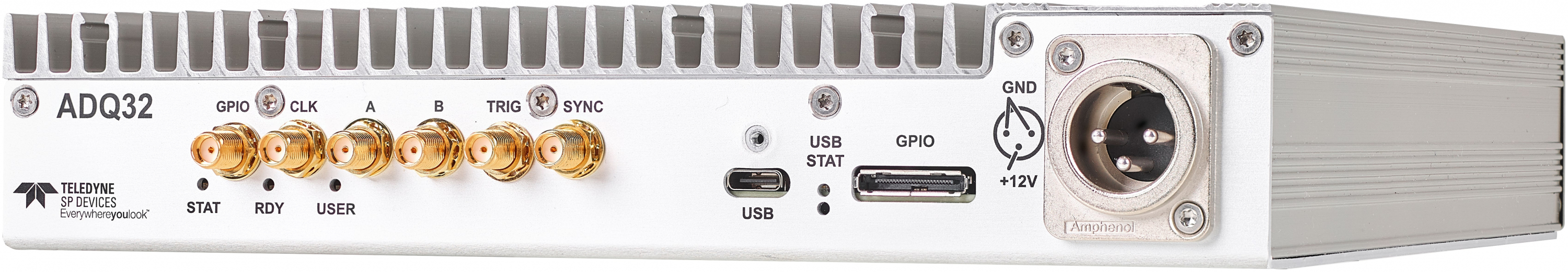

ADQ3-USB front I/O panel
Designed for high-performance data acquisition in compact, space-constrained environments, the ADQ3-USB brings the full capabilities of the ADQ3 platform into a stand-alone USB 3.2 form factor offering up to 10 Gigasamples-per-second (GSPS) sampling rate and 2 Gbyte/s sustained data transfer to a host PC.

The ADQ3-USB is housed in a robust, fanless enclosure that supports side-by-side mounting of two units in a standard 1U 19» rack. This compact design allows users to place the digitizer close to the detector, minimizing cable length and reducing signal reflections, an essential factor for optimizing analog performance in high-speed applications.
It supports continuous data streaming at up to 2 Gbyte/s via USB 3.2, with onboard FPGA capabilities for real-time signal processing. Even large volumes of raw data up to 20 Gbyte/s can be efficiently reduced and transferred without bottlenecks. By eliminating the need for PCIe slots, the ADQ3-USB enables fast and simple integration with mini-PCs and laptops, making it suitable for mobile setups, embedded systems, and OEM applications.

The ADQ3-USB is compatible with a wide range of digitizer models within the ADQ3 series, including ADQ30, ADQ32, ADQ33, and ADQ35. Each model offers different sampling rates, bandwidths, and channel configurations. For example, the ADQ32-USB offers 2.5 GSPS sampling and 2.5 GHz bandwidth, while the ADQ35-USB supports up to 10 GSPS for ultra-fast applications.
